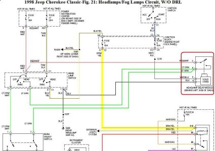

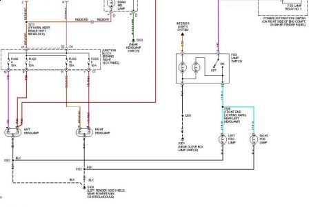

1998 Jeep Cherokee Headlights Low Beam Failing intermittant
1998 JEEP CHEROKEE
92,300 MILES • 6 CYL • 4WD • AUTOMATIC
VAL PERIMAN
Switching to low beams often results in sudden and complete darkness. Scarry! Is this the subject of Recall campaign 04v086000 as mentioned in your answer to Chanute, KS, 2005-02-18? Thanks friends.
Mar 23, 2009 at 9:36 AM
ZACKMAN
  • 4,202 POSTS
The recall you mentioned is only for Honda Insight, not for your Jeep. I believe your problem lies within the headlamp delay module.
