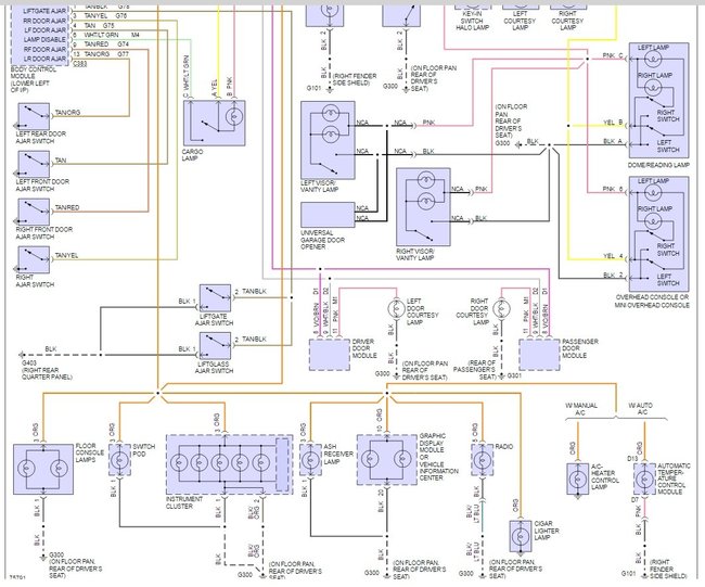

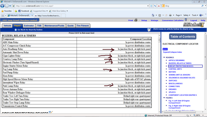

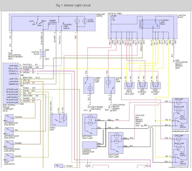

RIVERMIKERAT
  • 6,110 POSTS
Check the main junction block under the right side of the dash. I have attached an image with the relays that are co-located there pointed out. Let us know which one is clicking, and I'll send you a schematic for that system so you can track the short.
