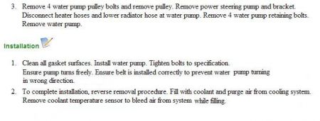

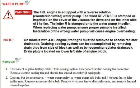

We are trying to replace the water pump in our 1996 Jeep Grand Cherokee Laredo. The problem is that we are having trouble accessing the water pump. Any suggestions on a way to get to it?

https://www.2carpros.com/forum/automotive_pictures/261618_Noname_1512.jpg
https://www.2carpros.com/forum/automotive_pictures/261618_Noname2_450.jpg
