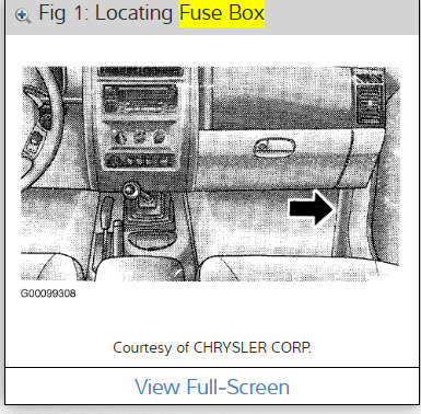

RLBSTUCKINHOU
  • 11 POSTS

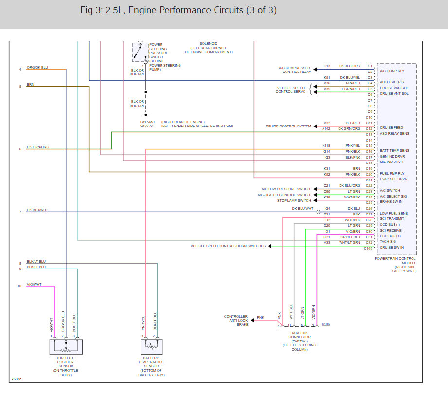

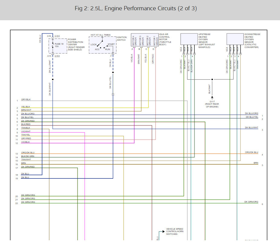

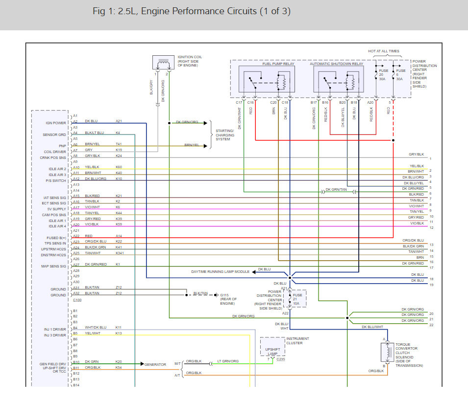

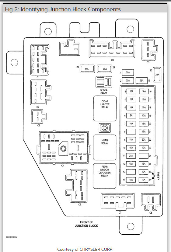

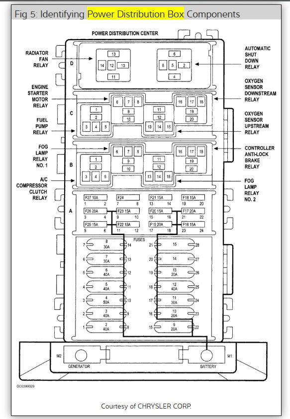

Let check the fuses first by using the guide and the fuse locations below. I also have the fuel pump wiring diagrams so you can see how the system works.
Check out the diagrams (Below). Please let us know what you find. We are interested to see what it is.

Do you power to the fuel pump relay socket?
Jul 17, 2019 at 2:17 PM (Merged)
RAINWIZARD8
  • 9 POSTS
I do not, its like it's shut down somewhere between the harness and pump. I also have no fire going to the coil or plugs and my light on instrument panel work, but no gauges do. I have checked numerous things like the Balast resister, ignition switch, neutral safety switch, crankshaft sensor, and shift selector switch, fuses and relays too... any other suggestions what to check????
JAMES W.
  • 2,394 POSTS

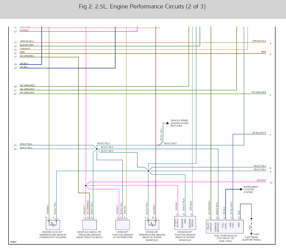

There is a module mounted on the fuel tank that the pump circuit passes through. If fuse # 16 in the underhood fuse block is good and you have power to the FP relay socket, the problem must be with the module.
The dash gauge system is feed with 2 circuits. 1- fuse #16 in the underhood block. 2- #9 in the block behind the right side kick panel.
