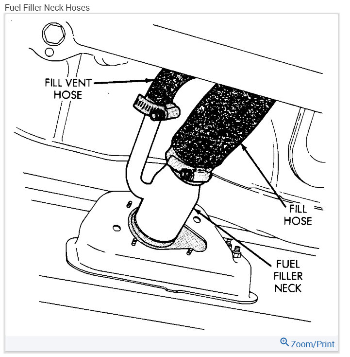

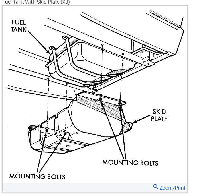

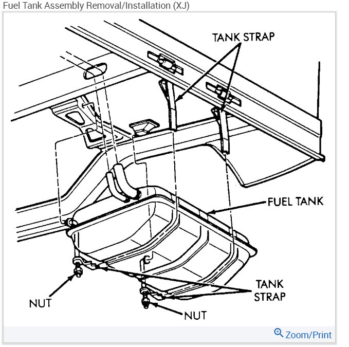

The Fuel Pressure Regulator can be replaced...it's located on the fuel pump assembly (in the tank), but can be replaced without purchasing a whole new pump assembly. Some say you can do this without taking the tank down but the manual says you do.
Here is a diagram to help show you how.
https://www.2carpros.com/articles/how-to-replace-an-electric-fuel-pump

Yep, thanks for the guide and diagram worked perfect I took the tank down though I can see that you can get your hands in there to do the job if you had too.
