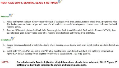

how can i change the rear axle on 1996 jeep cherokee
