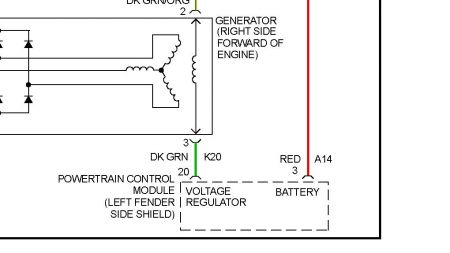

What is the normal operating voltage of the alternator. when I first purchased the vehicle it was always over the 14 mark and over the last 2 years I have replaced the alternator twice. It is never over 13.1 V now. Could there be a reason it is so low? I have had a new radio installed and replaced the fog lights with brighter ones.

It has been tested and is fine. I replaced the alternator today and at it's highest voltage it is 13.1 and it lowest (lights on, radio on) it is at 12.6. I did not try the a/c or any other accessories. When I step on the accellerator the volts don't go up. Does this year have an external voltage regulator? Could that be the problem?

Could a problem with the computer controlled voltage regulator-see below
https://images.2carpros.com/forum/automotive_pictures/12900_regulator_3.jpg
