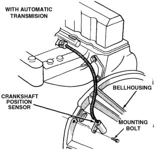

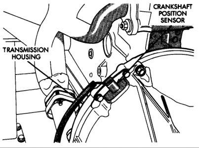

Won't start- put new pick-up in dist./new plugs-no fire -Q,does this car have a crank pos. sensor? If so were is it.Ive looked at the bell housing underneath at about 11:00 and i dont see nothing. HELP PLEASE

Crankshaft Position Sensor
https://images.2carpros.com/forum/automotive_pictures/12900_c_14.jpg
Automatic Shown Standard Similar
https://images.2carpros.com/forum/automotive_pictures/12900_c1_41.jpg
The connector is on the rear of the intake manifold. https://www.2carpros.com/kpages/auto_repair_manuals_alldata.htm
