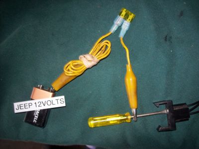

Well Big Guy, I am no expert, and I might take this one step further, I myself, in order to maybe save $, (Mr. Risktaker, who by some means on 10 MAR 1981, Had his high school machine shop project, a 16th century naval type .50 Caliber cannon, accidently?!?!, blasted a thru and thru hole in his arm, just below the shoulder), Attempt 1) Would probably remove the light multifunction switch, remove the switch off or the wire harness, introduce 12v to all systems, at its "plug-in", after a recon of the wire diagram so I only touch out-going 12v pins. Using a something similar to this TEST as in pic set-up below, as to maybe not fry something.If there is a short, my 20 amp fuse will blow at that pin (whatever its function is, providing I am not on a ground)confuse the hell out of you, yet?
https://images.2carpros.com/forum/automotive_pictures/411289_100_0455_1.jpg
Attempt 2)Self service salvage yard for cheap replacement. Hope for a GOOD one, not messed up, too Attempt 3)----Give up on eliminating switch factor, buy a new one at auto parts store, definitly, take it out of the equation.!! YOUR TAKE ON IT? Love, Turddog
