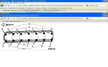

I am trying to find out the proper sequence and specs for tightening the head bolts.

2. Position the engine cylinder head gasket (with the numbers facing up) onto the cylinder block. CAUTION: Engine cylinder head bolts should be reused only once. Replace the head bolts if they were used before or it they have a paint dab on the top of the bolt. Fig. 6 Engine Cylinder Head Assembly 3. With bolt # 14 held in place (tape around bolt), install the engine cylinder head. Remove the tape from bolt # 14. 4. Coat the threads of stud bolt # 11 with Loctite (TM) 592 sealant, or equivalent. Fig. 7 Engine Cylinder Head Bolt Tightening Sequence 5. Tighten the engine cylinder head bolts in sequence according to the following procedure Fig. 7 : 1. Tighten all bolts in sequence (1 through 14) to 30 N.m (22 ft. lbs.) torque. 2. Tighten all bolts in sequence (# 1 through 14) to 61 N.m (45 ft. lbs.) torque. 3. Check all bolts to verify they are set to 61 N.m (45 ft. lbs.) torque. 4. Tighten bolts (in sequence): o Bolts # 1 through 10 to 149 N.m (110 ft. lbs.) torque. o Bolt # 11 to 13 N.m (100 ft. lbs.) torque. o Bolts # 12 through 14 to 149 N.m (110 ft. lbs.) torque. CAUTION: During the final tightening sequence, bolt # 11 will be tightened to a lower torque than the rest of the bolts. DO NOT overtighten bolt # 11. 5. Check all bolts in sequence to verify the correct torque. 6. If not already done, clean and mark each bolt with a dab of paint after tightening. Should you encounter bolts which were painted in an earlier service operation, replace them.

There you go.
