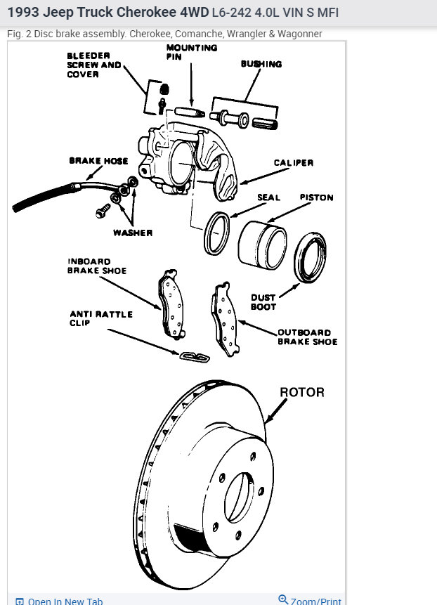

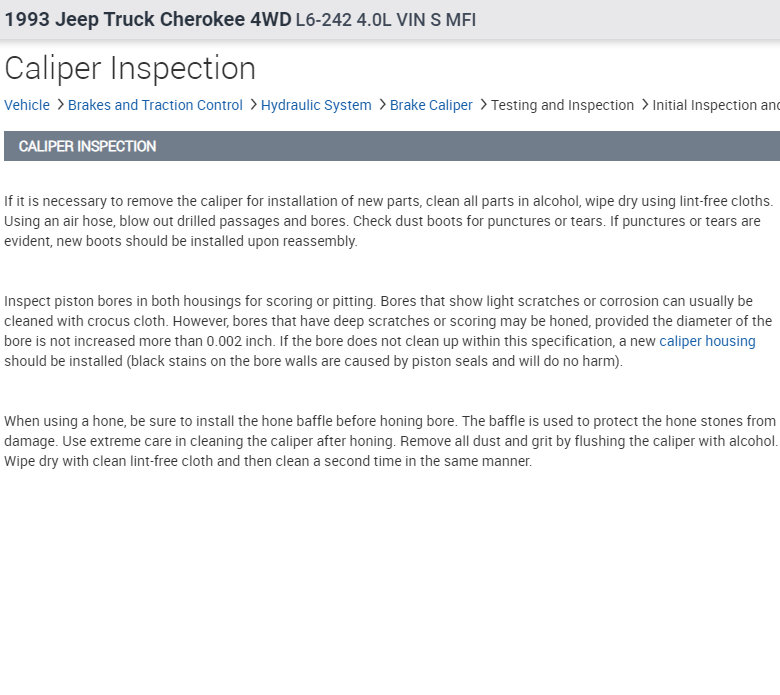

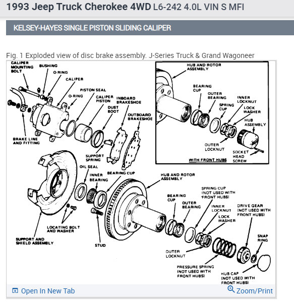

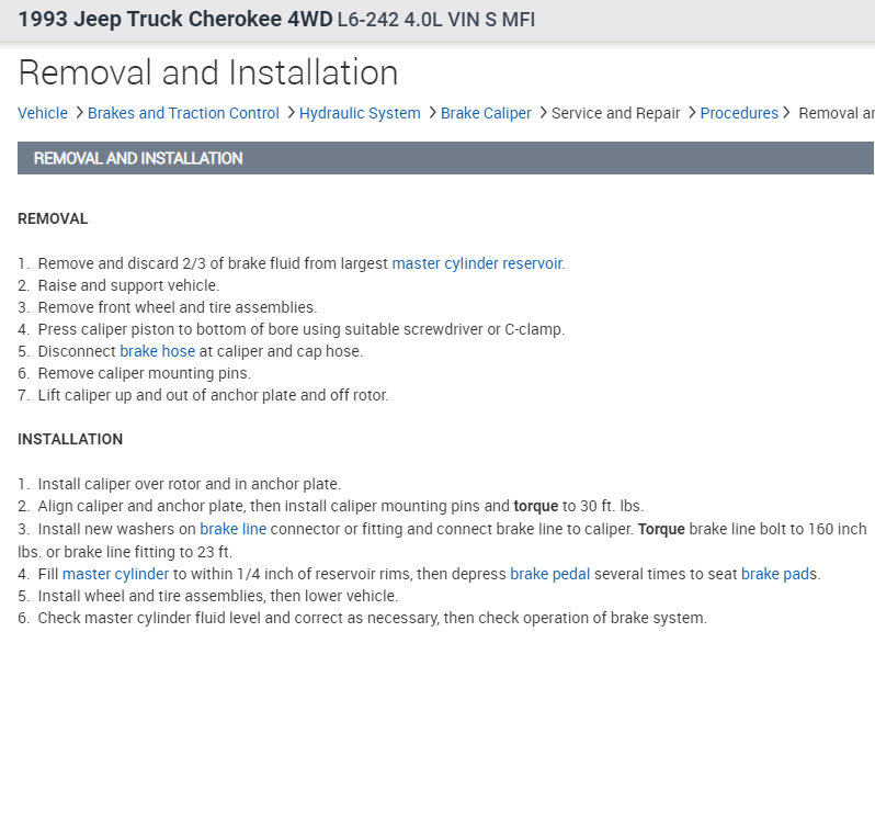

Seized caliper can create erratic braking. It can also warp the rotors which can lead to vibration under braking.
I have attached the caliper replacement procedure below.
