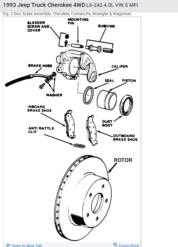

when i apply the brakes the front end will shake very violently, we cannot figure out what is wrong with it we have tried rotating the tires, replacing the steering dampener, and changing brakes.. but nothing seems to stop the shake, and what is even weirder is it doesn't happen every time i slow down.. so if someone could help me out id appreciate it

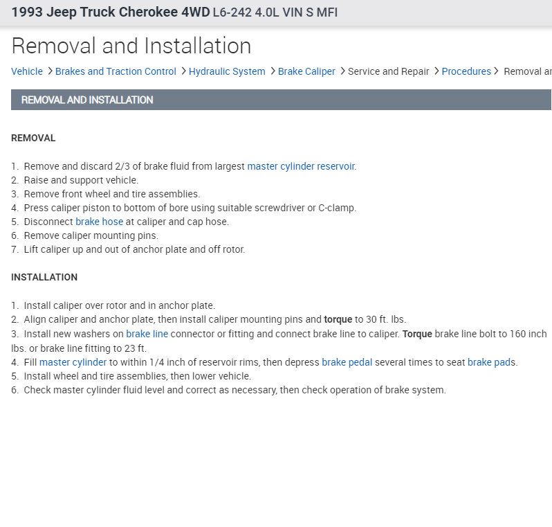

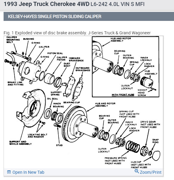

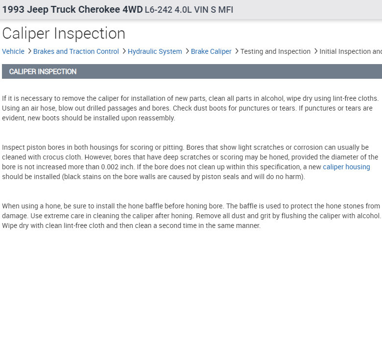

Seized caliper can create erratic braking. It can also warp the rotors which can lead to vibration under braking.
I have attached the caliper replacement procedure below.
