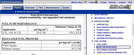

Ok my inline 6 want to crap it starts fine. But as soon as it starts it dies runs for 2 seconds then dies or Idles really rough then dies. Best I can figure it does so untell it uses up the fuel pressure. So far I have changed:

I hooked up a pressure guage to the fuel line and before parts it was about 31psi before start then would drop to 15 after start and then just kept falling tell it died. Now that I changed the fuel pump its worse.

When the pump is turned off or stops running, the system should hold residual pressure for several minutes (look up the specs to see how much pressure drop is allowed over a given period of time). If pressure drops quickly, the vehicle may have a leaky fuel line, a leaky fuel pump check valve, a leaky fuel pressure regulator or one or more leaky fuel injectors. Low residual fuel pressure can cause hard starting and vapor lock during hot weather.

So with what u have said ive done all but the injectors. It is also sucking in alot of air more then it used to. And it is also backfireing if u hit the throttle and let it go it backfires in the intake not sure if this helps. But it build pressure at start then slowly goes down

Yes I did track down my problem. The problem was a little ceramic box on the driveside quarter panel under the hood it only has 2 wires to it I cut them and connected them together and it works just fine. I belive the box was the fuel pump shutoff switch. (Used if in a wreck it auto kills engine) but I wired the 2 wires together and after 600 in parts that I didnt need it was that little box. Hope u get yours running.
