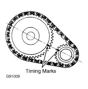

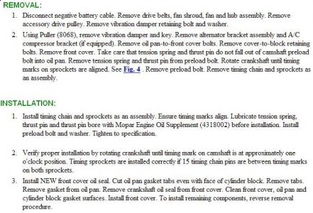

My water pump went bad. So i went to install a new one. i had to remove timing belt and in process i ended up moving the wheels its on. So Im putting my car back together now and i do not kno the order to put it in. Can anyone help? or have any idea where i can find help.? or kno where i can download a manuel.

Is this a Cherokee , Cherokee Sport etc..? Is it a timing belt or a timing chain?
Jun 11, 2009 at 2:44 PM
PIMP951231
Its a 93 jeep Cherokee sport. I think its a timing belt but i i ask this question on a couple of of forums and there sayin a timing chain. Well dpes anyone know how 2 set up a timing chain
Jun 12, 2009 at 2:11 AM
BLUELIGHTNIN6
  • 16,542 POSTS
Yes, it is a timing chain. Below are procedures for removing and installing your timing chain.
