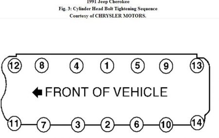

need torque specs for cylinder head bolts

Use the three stages below in the tightening sequence that follows except bolt number 11. Tighten 11 to 100 Ft. Lbs. (136 Nm) [for the final stage] Stage 1 - 22 Ft. Lbs. ( 30 Nm) Stage 2 - 45 Ft. Lbs. (61 Nm) Stage 3 - 110 Ft. Lbs. (149 Nm)
https://images.2carpros.com/forum/automotive_pictures/261618_Noname_329.jpg
