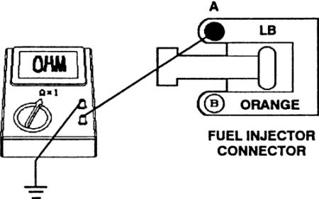

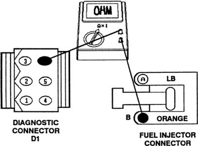

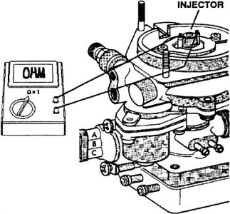

Hi, I am having some problems with my jeep I have no pulse. I have checked every fuse and all of them are still good. I am horrible with electrical. I have spark and fuel in the fuel rail too. please help.

check fuel pressure it should be 31 PSI(Pounds per Square Inch) also here is the testing for injector TESTING See Figures 2, 3 and 4

Fig. 2: Checking the circuit resistance between diagnostic connector terminal 6 and fuel injector connector B With the ignition key/switch in the OFF position, unplug the fuel injector 2-way connector and use an ohmmeter to check the resistance between terminal B of the injector connector and terminal 6 of the diagnostic connector. If the resistance measures greater than 5 ohms, repair the open circuit between those terminals.

Fig. 3: Checking resistance between terminal A of the injector connector and a good ground If the resistance measures below 5 ohms, check the resistance between terminal A of the injector connector and a good ground. If the resistance measures below 5 ohms, turn the ignition key/switch to the OFF position and unplug the ECU connector, then check the resistance between terminal A of the injector connector and a good ground. If the resistance measures greater than 5 ohms, replace the ECU. Connect the ECU connector.

Fig. 4: Checking resistance across the terminals of the fuel injector Check the resistance across the fuel injector terminals. If the resistance measures greater than 5 ohms, replace the fuel injector.
