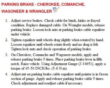

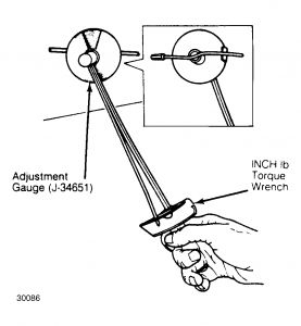

How to adjust the emergency brake?

https://images.2carpros.com/forum/automotive_pictures/261618_Noname_2362.jpg
https://images.2carpros.com/forum/automotive_pictures/261618_Graphic_578.jpg
