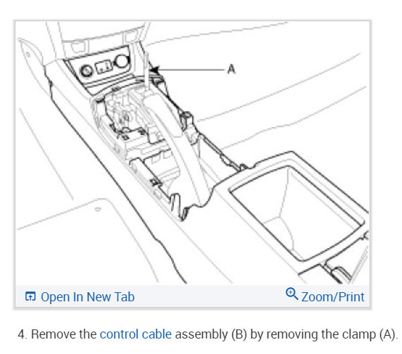

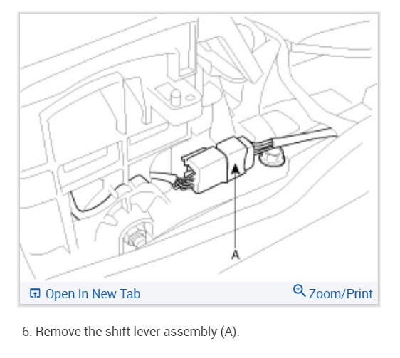

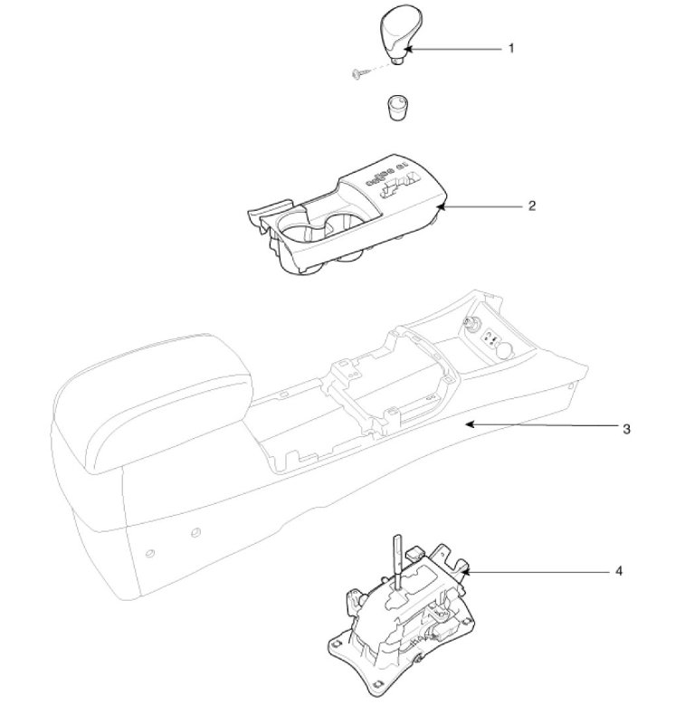

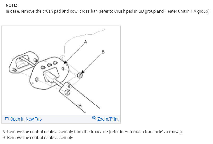

My Elantra had the shifter stuck in neutral. It couldn't be moved. I put the emergency brake on and waited for AAA since I couldn't move the shifter. The tow truck driver was able to release the shifter upon working with it. So I drove it to the dealer and they said that there was a recall, something to do with a switch that has been causing this problem and I had just not gotten my recall notice yet. Well, the shifter is working now after the recall work but I am totally unsure if the problem is fixed. Is there any way to know if I will run into this problem again or is it something where only time will tell?

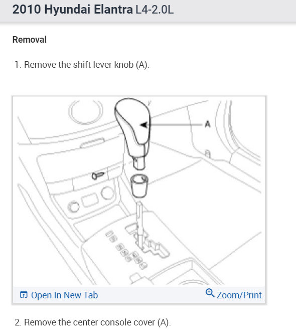

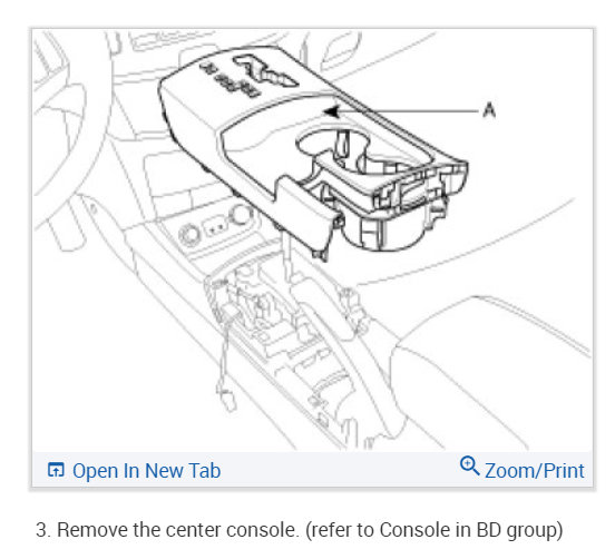

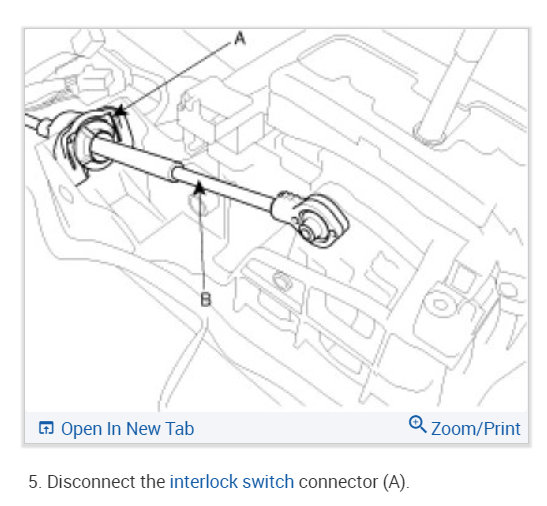

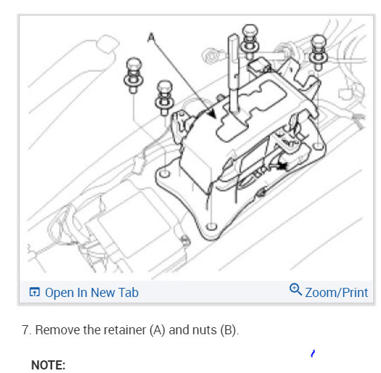

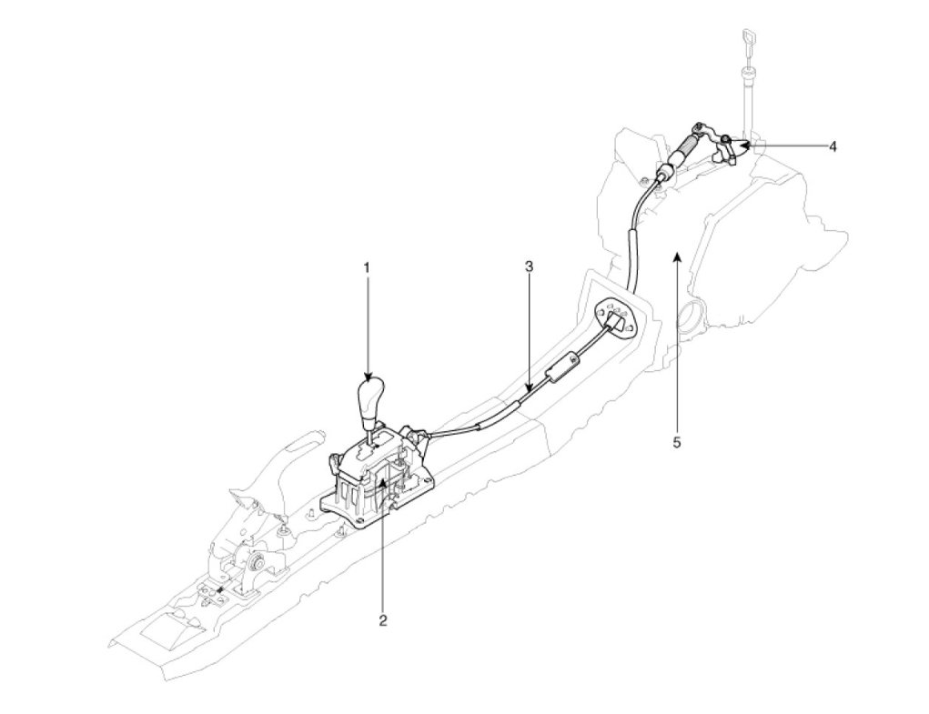

It sounds like they replaced the shifter assembly but to make sure take a look yourself here are diagrams below to how you how to take it apart so you can tell for sure.
