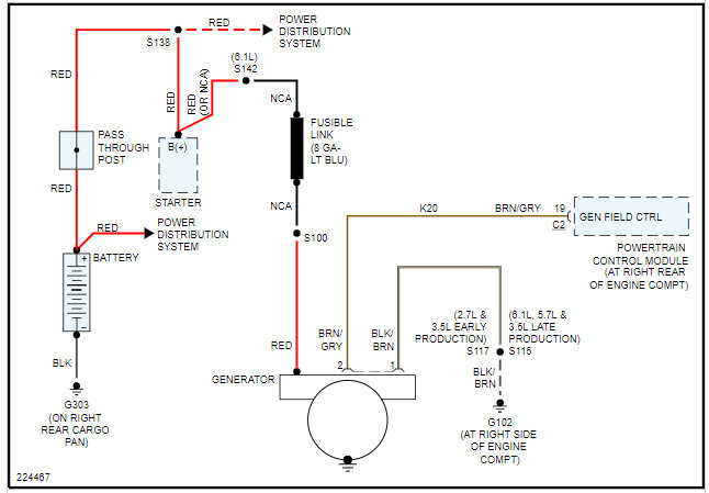

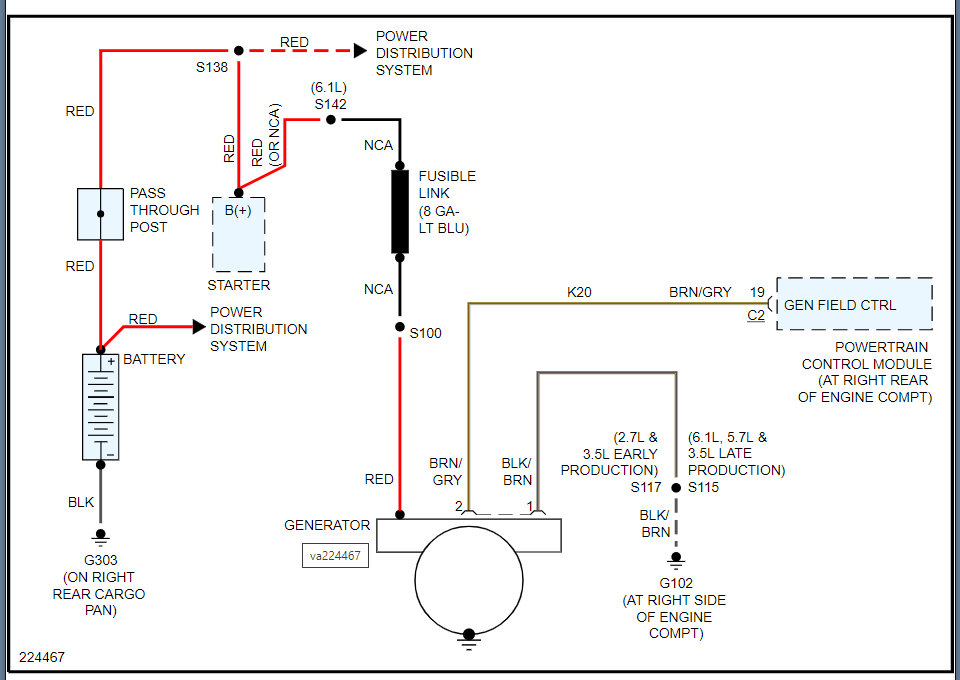

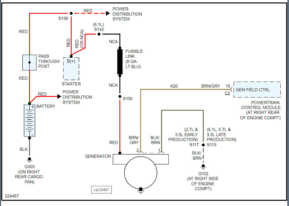

Couple things. First, I suspect the wire that is getting hot is the one from the PCM? See the wiring diagram below.
If this is the case, I have seen this a number of times. The alternators are failing because the driver (field control) in the PCM is shorted and causes the alternator to fail and even to cause the wiring to melt.
The solution to this is to replace the PCM and alternator if it is failed.
Also, if the wiring is damaged then it needs to be replaced as well.
Even if you change to the older style alternator this will be an issue until it is fixed. So I would suggest just repairing this and go with the OEM alternator.
Please see the wiring diagram below and let me know what questions you have.

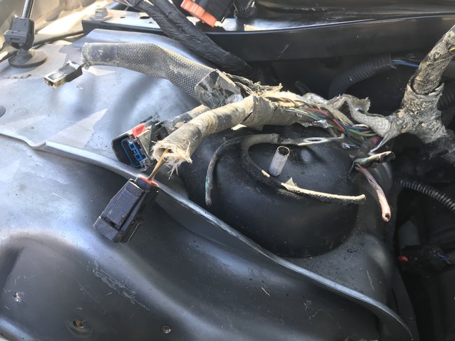

Found this at the starter.
Sep 26, 2021 at 8:18 AM

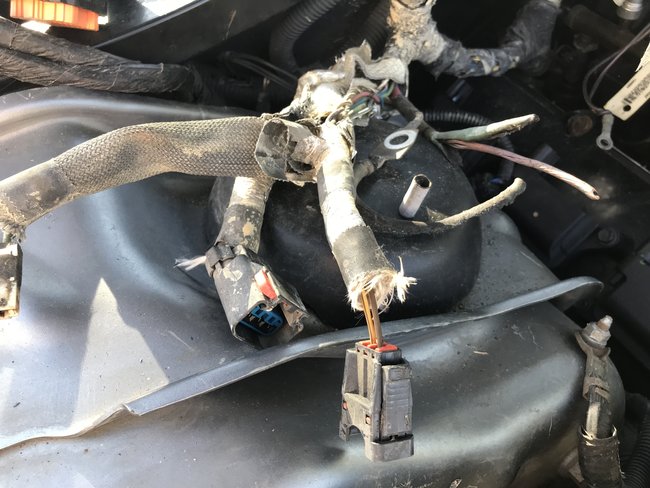

Another view.
Sep 26, 2021 at 8:19 AM
SSOTORPS
  • 14 POSTS
Those are 2 views of wire from alternator to the starter. There it is bolted on top of the three way battery harness which bolts to the starter also, at the bulkhead coming through the passenger floorboard, and also to the front power distribution box front right fender.
All battery cables ohm out .04 to .06 except for the one in the photo.
The black/brown wire at alt is .06 ohms.
The brown/grey wire at alt (field) is .034.
Sep 26, 2021 at 8:27 AM

Wow. Great find.
Clearly the priority is to fix those wires. Then to find out if the alternator is okay, we just need to test it again. Most parts stores can do this free of charge. Here is a guide that will show this type of testing:
Let us know what you find with this. Thanks for the updates so far.

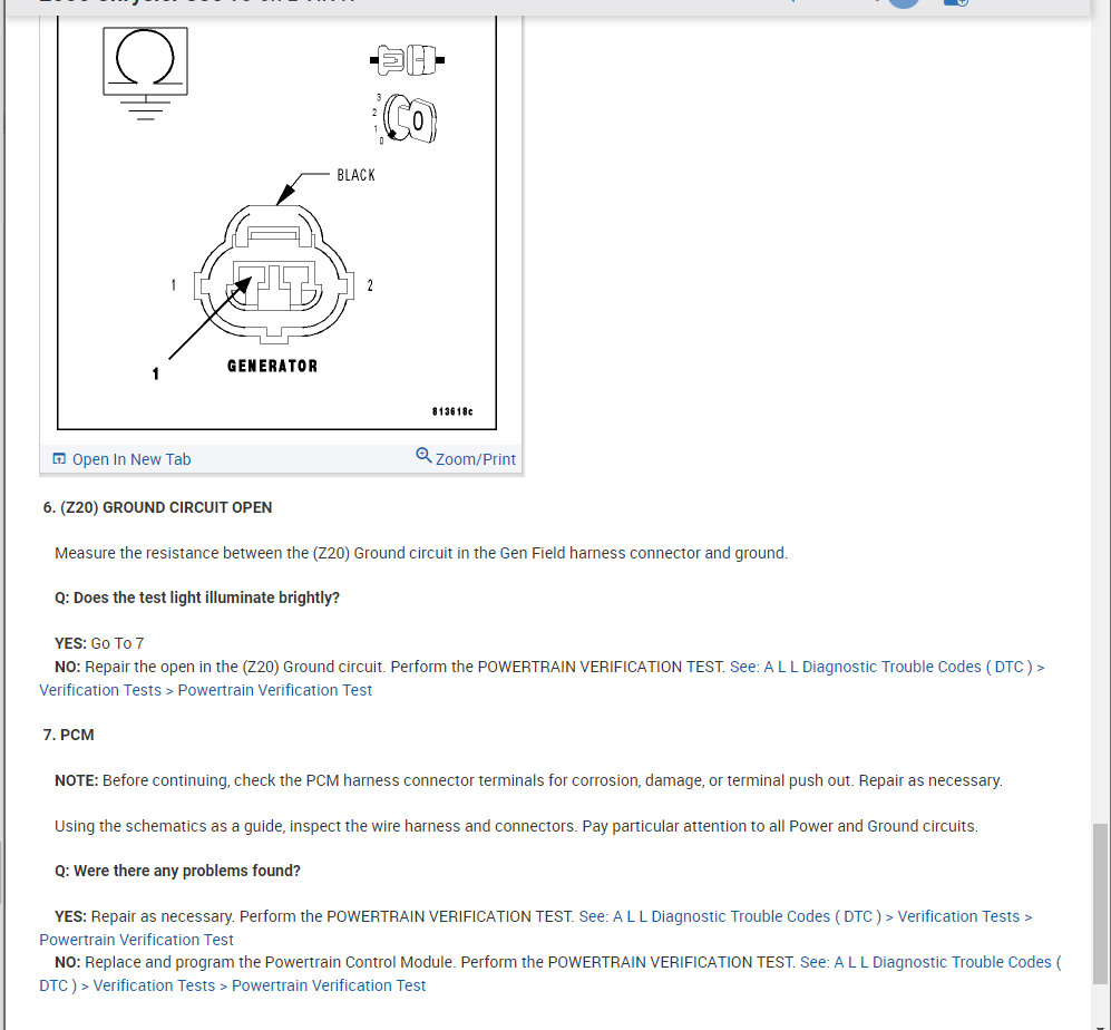

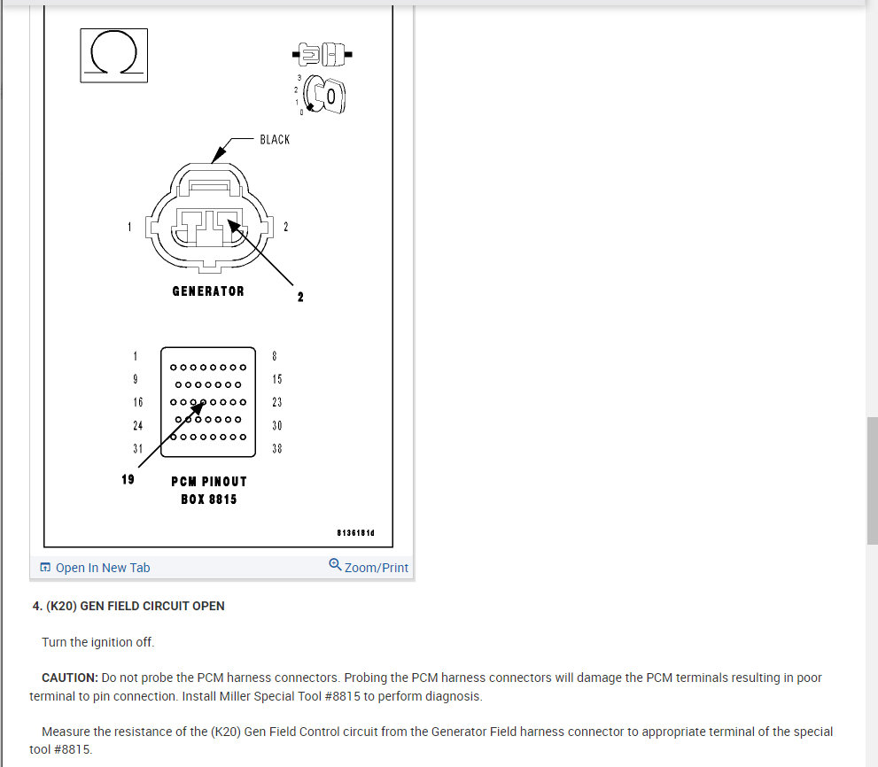

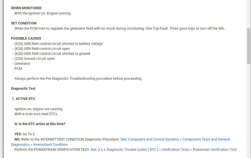

Okay. Just to be clear, the alternator is new again and it is producing 12 volts?
Basically, that is not turned on and you are just passing through the battery voltage.
Then all these U codes go away when you have a battery charger on the battery?

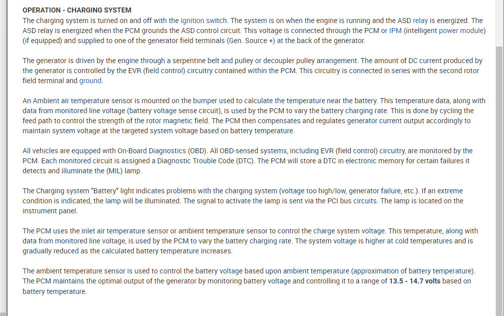

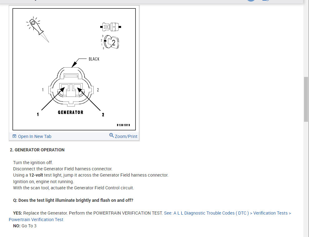

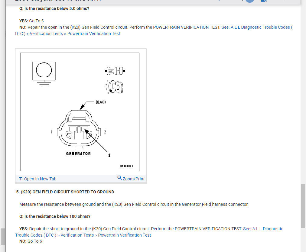

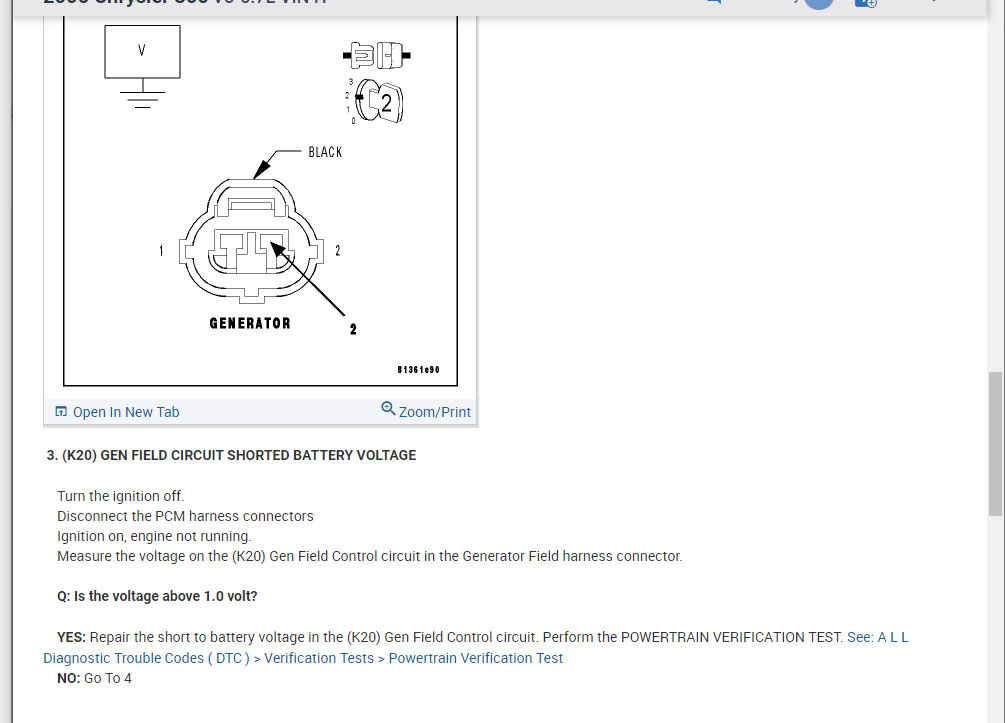

Lastly did the P0622 come in because you had the alternator unplugged? I attached the testing for this code but if you had the plug unhooked then that explains it as the generator sense circuit would be an open circuit.
However, no matter what I suspect your EVR in the PCM has failed so I would be sourcing a PCM but run through this testing if you want to confirm it further.
