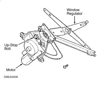

hi drivers window does not fully close when door shut. passenger window goes down everytime door handel operated but not up when door closed .

It may be necessary to adjust regulator up-stop. To do so, raise glass to fully closed position. Loosen regulator up-stop bolt. See Fig. 4 . Move stop rearward to contact regulator quadrant, and tighten regulator up-stop bolt. If adjustment is required, partially lower glass and adjust position of up-stop bolt.
https://images.2carpros.com/forum/automotive_pictures/266999_jag_28.jpg
