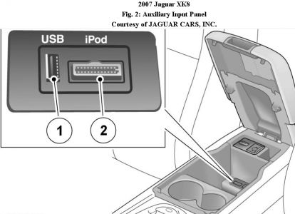

use the seek to get a weak station? Not scan, but seek. I would have figured Jag to have a factory Sat radio option? If your sat radio has USB cable hook into the auxiliary center. The iPod and USB connectivity allows audio files on portable media players and mass storage devices (i.e. portable audio devices) to be played through the speakers of the audio system. The audio system supports portable audio devices with a storage capacity up to 256 GB (approximately 65,000 music tracks). The iPod and USB connectivity is provided by:  An auxiliary input panel, installed in the cubby box of the floor console.  An auxiliary USB unit, attached to the RH rear quarter panel, behind the trim of the luggage compartment. The auxiliary input panel provides the interface between the portable audio device and the vehicle's audio system. An iPod port and a USB port are located in the top of the auxiliary input panel, underneath a protective rubber cover. An iPod connector lead is supplied with the vehicle. Portable audio devices can be connected to both ports at the same time. The iPod and USB ports both incorporate a charging function. The maximum charging current supplied is 500 ma.
https://images.2carpros.com/forum/automotive_pictures/62217_usb_1.jpg
