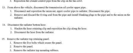

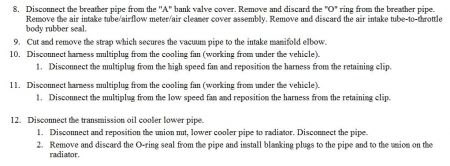

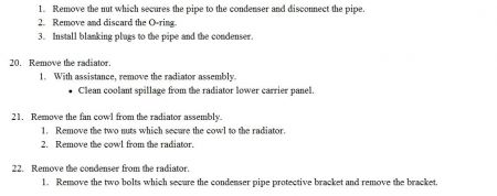

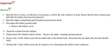

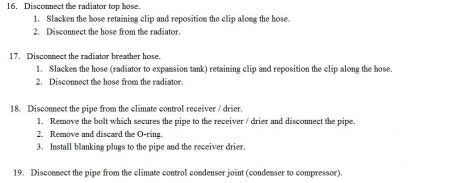

Need to know the labor hrs on the installation of a radiator and too i need to know basics on how to install like if i have to take the bumper off or any tips u may have to make this job eaisier! Thank You
Oct 18, 2010 at 10:45 PM
BLUELIGHTNIN6
  • 16,542 POSTS
an experienced repair shop should be able to replace the radiator on this vehicle in approximately 3 labor hours. below are the proper removal steps..
