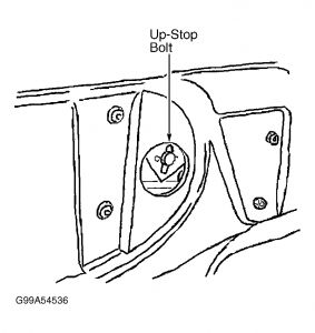

car is a convertible and when the door is opened the window is supposed to drop approximately one half inch and go back up when the door is closed. the window on my car will NOT go back up automaticly when the door is closed. Resetting the memory does not help. The window keeps dropping more each time the door is opened. the window operates correctly with the inside switch, just will not go back automaticly when the door is closed. The passenger window operates correctly.

Recheck alignment of glass, raising an lowering glass several times. Readjust if necessary. Raise glass to fully closed position and disconnect battery from motor. Loosen regulator up-stop bolt. See Fig. 2 . Move stop rearward to abut regulator quadrant, and tighten regulator up-stop bolt.

Glass is not out of alignment in any way. I think it has to be an electrical or computer probem. Your thoughts ???????

My next step would be to replace the DDCM .. (Driver Door Control Module In driver door)
