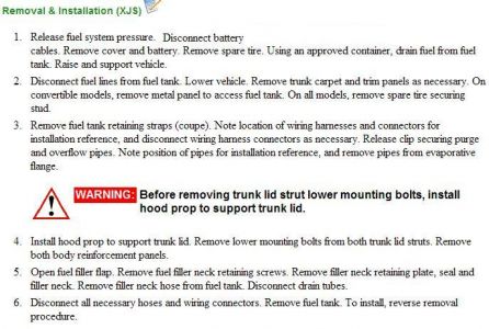

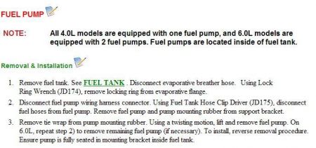

How do I remove and replace the fuel pump? Please explain about the clips on the in tank fuel pump.

FUEL TANK
