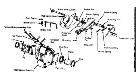

What is involved in replacing the rear inboard rotors and pads?

PARKING BRAKE DISC PADS Removal & Installation Remove parking brake caliper. See PARKING BRAKE CALIPER under REMOVAL & INSTALLATION. Remove pad-to-carrier mount nut. Note pad position and remove disc pads. See Fig. 4 . To install, reverse removal procedure. Repeatedly operate parking brake actuating lever until adjuster ratchet stops clicking. Ensure parking brake cable is adjusted properly. See PARKING BRAKE under ADJUSTMENTS. PARKING BRAKE CALIPER NOTE:Reason for majority of parking brake caliper problems is lack of lubrication of internal caliper components. Removal Raise and support vehicle. Fully release parking brake lever. Loosen parking brake cable adjusting lock nuts and back-off cable adjustment. Remove rear suspension mounting plate attaching nuts and bolts. Plate has 14 bolts and is located directly below differential carrier. Remove rear suspension mounting plate from vehicle. Using a pry bar, move caliper arm toward center of vehicle. Disconnect parking brake cable from parking brake caliper operating lever and slide back rubber sleeve. See Fig. 2 . Fig. 2: Identifying Parking Brake Calipers Courtesy of JAGUAR CARS INC. Remove return springs from caliper operating levers and position parking brake cable clear of calipers. Open caliper retaining bolt lock tabs. Remove parking brake caliper mounting bolts, lock tab and retraction plate. See Fig. 4 . Slide caliper around rotor and remove through hole left by suspension plate. To remove brake pads, remove nut and spring washer securing pads to pad carriers. Replace pads if lining thickness is .125" (3.17 mm) or less. Installation To install, reverse removal procedure. Adjust caliper if new pads have been installed or if caliper has been overhauled. Adjust by holding one pad carrier stationary and turning remaining carrier out 2-3 times or until there is a clearance of .75" (19 mm) between disc pad surfaces. Install caliper. Ensure caliper retaining bolts are installed correctly. Operate caliper actuating lever until adjuster ratchet stops clicking. Install remaining components and check brake operation.
