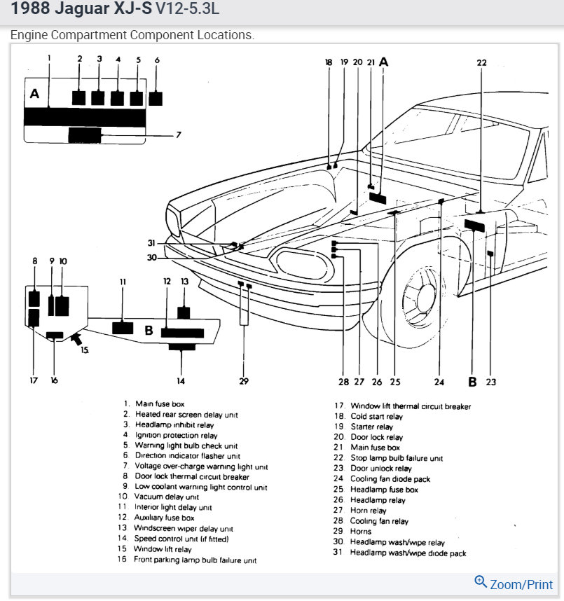

Suspect flasher unit. Where did they hide that thing?
Sunday, June 1st, 2008 AT 7:11 AM
DAVE H
MECHANIC
13,384 POSTS
The turn signal flasher is under the dash on the right side. Here is a diagrams that shows where it is #6
