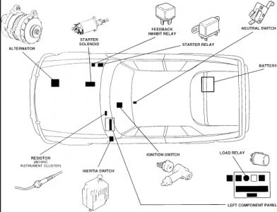

1985 Jaguar XJS V12 Automatic
can you tell me where the starter is and how to remove it
Aug 16, 2010 at 8:15 AM
  • 75,992 POSTS
Locations -Starting System Battery, Starter, Alternator
https://images.2carpros.com/forum/automotive_pictures/12900_s_18.jpg
1.Disconnect battery ground cable. Raise and support vehicle. 2.Remove right exhaust pipe from over-axle pipe forward. 3.Remove right front catalytic converter assembly for access. 4.Remove heat shield from starter. 5.Disconnect starter leads from solenoid. 6.Loosen starter mounting bolts, then remove starter motor. 7.Reverse procedure to install. https://www.2carpros.com/kpages/auto_repair_manuals_alldata.htm
