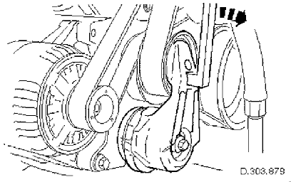

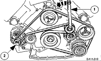

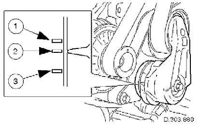

I need the procedure for replacing the two accessory drive belts on my 2002 Jaguar XJR.

Disconnect RH fan motor connector.

Check supercharger drive belt length by observing belt wear indicator marks on side of tensioner. Pointer at this mark, indicates minimum new belt length. Pointer at this mark, indicates maximum new belt length. Pointer at this mark, indicates belt must be renewed.

Remove drive belt from supercharger. Fit 1/2 inch square drive ratchet or bar into square aperture on front face of tensioner. Using bar, turn tensioner assembly to the right (viewed from front) against spring tension. Whilst holding the tensioner against spring tension, remove drive belt from tensioner pulley. Release tensioner slowly and remove bar. Disconnect belt from other pulleys and remove it from rear of tensioner. Installation NOTE: Ensure that belt is correctly and squarely located on each pulley. Check belt wear indicator marks to confirm that drive belt is within limits. Installation is a reversal of the removal procedure. Accessory drive belt - vehicles with supercharger Removal Open the engine compartment and fit paint work protection sheets. Remove the supercharger drive belt, for access. See: Drive Belt, Supercharger Check the belt wear indicator marks to confirm that the drive belt is/is not within limits.
https://images.2carpros.com/forum/automotive_pictures/248015_Belt_1_2.gif
CAUTION: When releasing the belt tension, never apply any torque in a clockwise direction to the pulley center bolt (left hand thread) as it could subsequently loosen. Remove the drive belt from the accessory drive. Use a spanner e.g. Churchill JD-230 or Snap On XDHM 1415, on the center bolt of the belt tensioner idler pulley, to turn the adjuster assembly to the left, viewed from the front, against spring tension. Whilst holding the tensioner against spring tension, remove the drive belt from the generator pulley. Release the tensioner slowly and remove the spanner. Disconnect the belt from the other pulleys, as necessary. Installation Installation is the reverse of the removal procedure. Ensure that the belt is correctly and squarely located on each pulley. Refit the supercharger drive belt.
