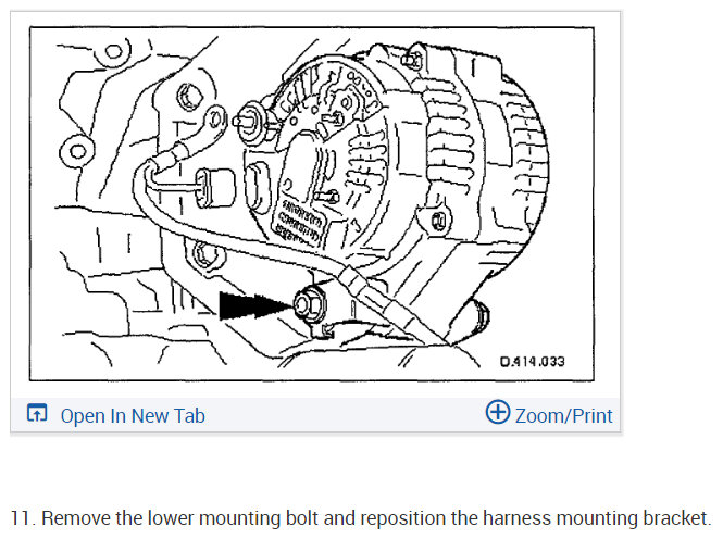

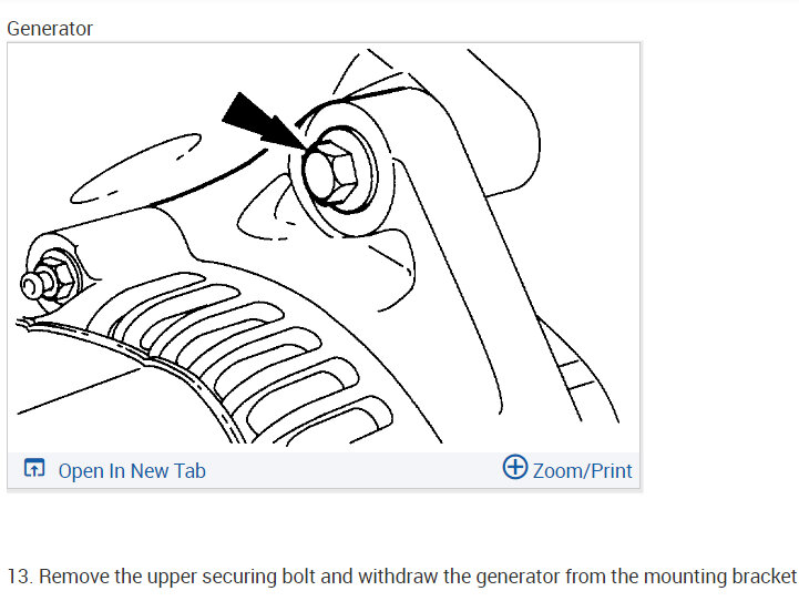

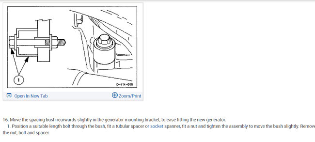

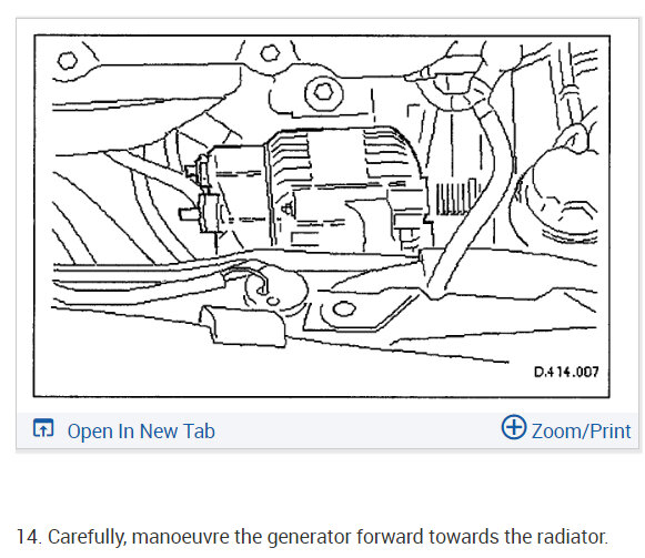

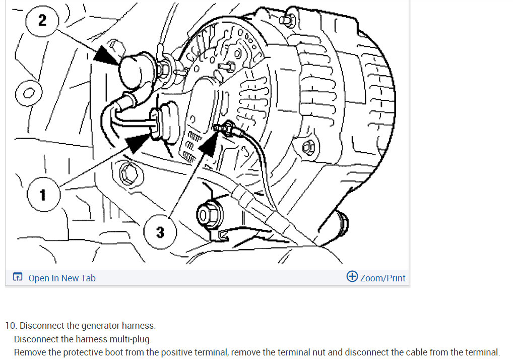

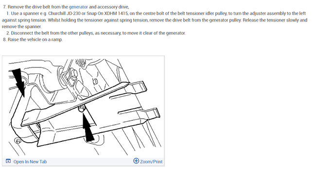

  • 55,673 POSTS

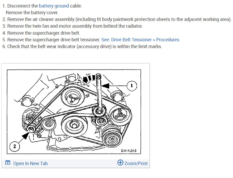

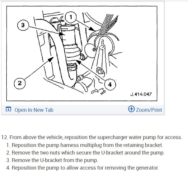

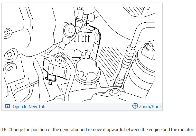

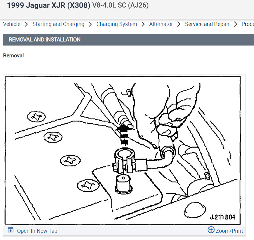

It sounds like you have a defective battery or alternator which is not charging the battery, Here is a guide to check the alternator and how to replace it if it fails the test. You will need to jump it to get it going for the test.
and
https://www.2carpros.com/articles/how-to-jump-start-car-battery-using-jumper-cables
Check out the images (below). Let us know how it goes
