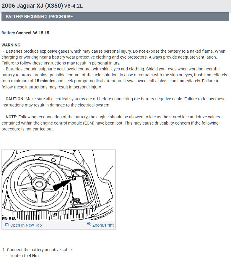

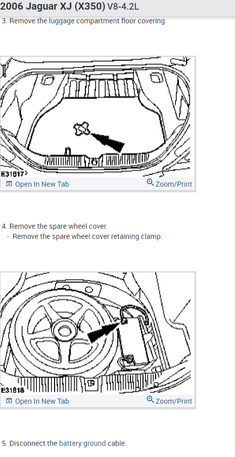

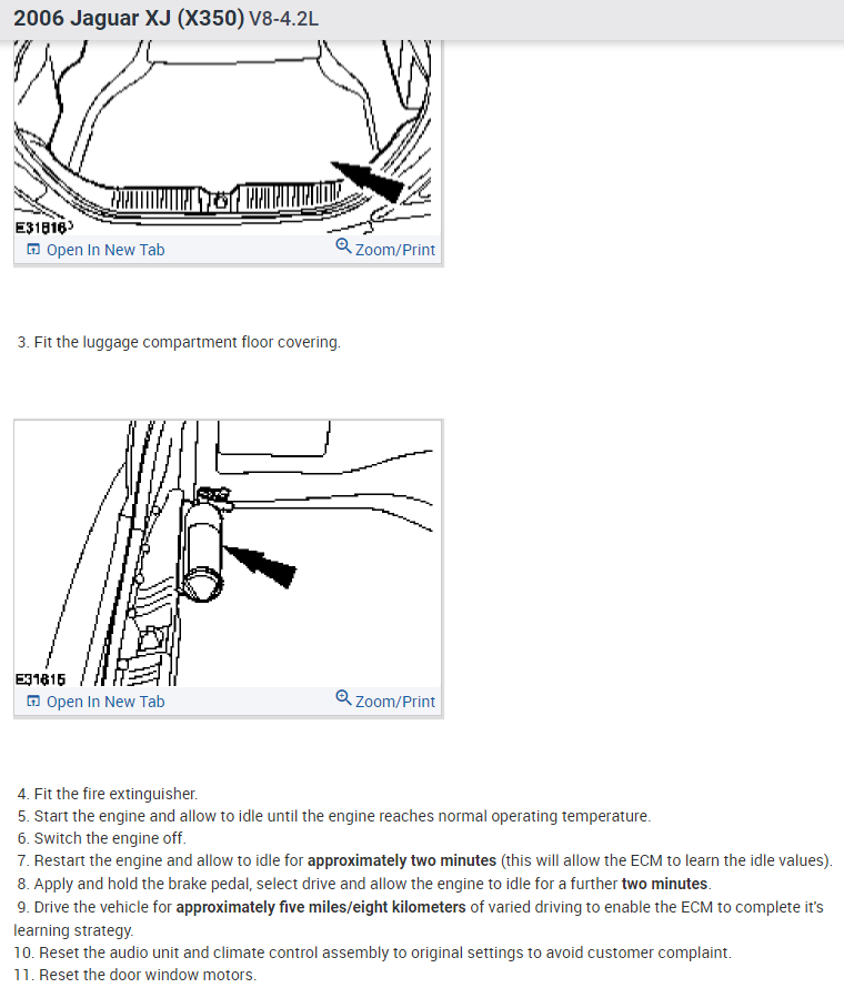

I am looking for advice on the correct procedure when replacing the battery. Any advice would be gratefully received. Thanking you in advance for your assistance.
Promanuk
Dec 26, 2009 at 5:34 AM
SQM
  • 6,383 POSTS

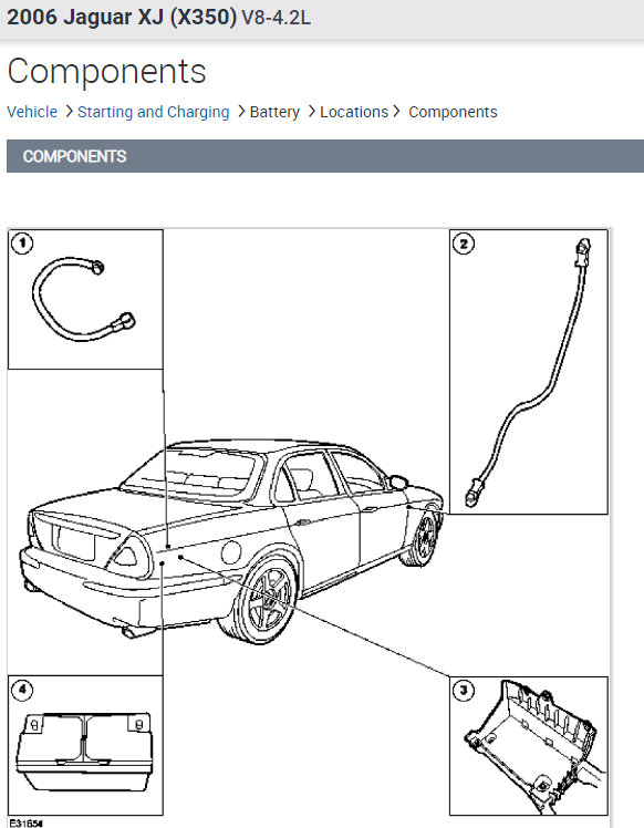

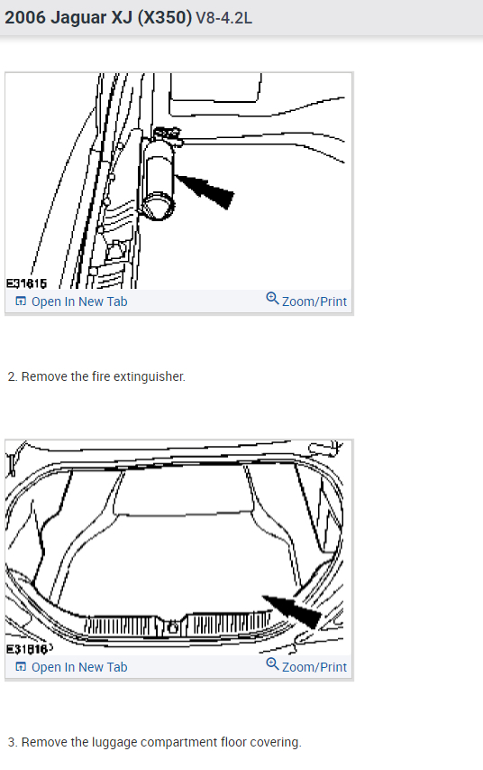

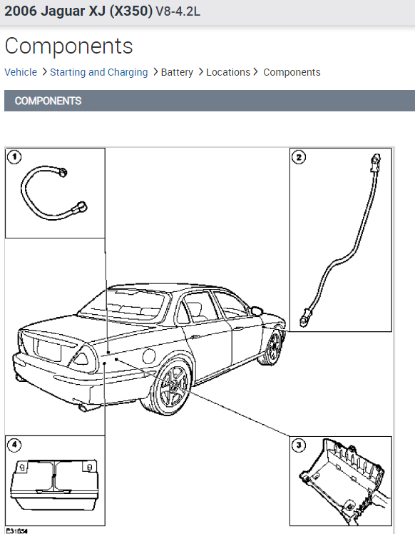

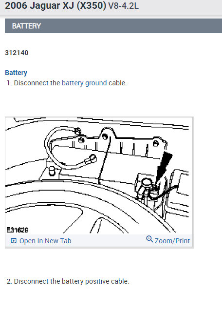

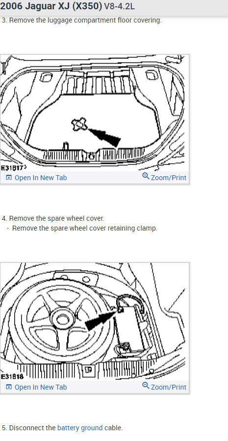

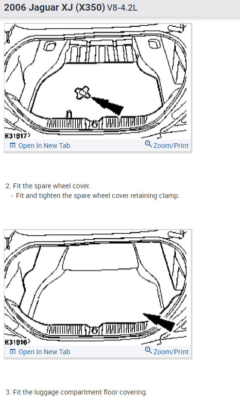

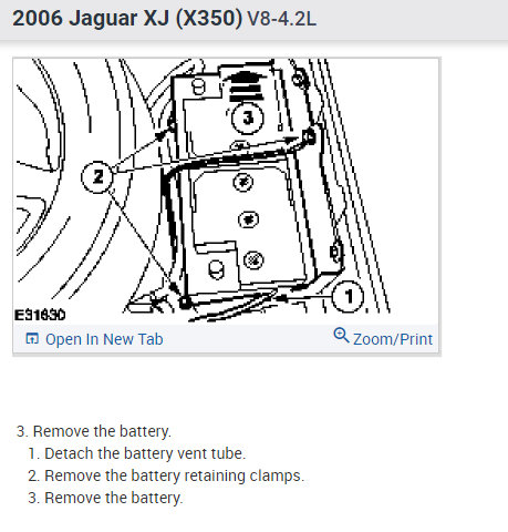

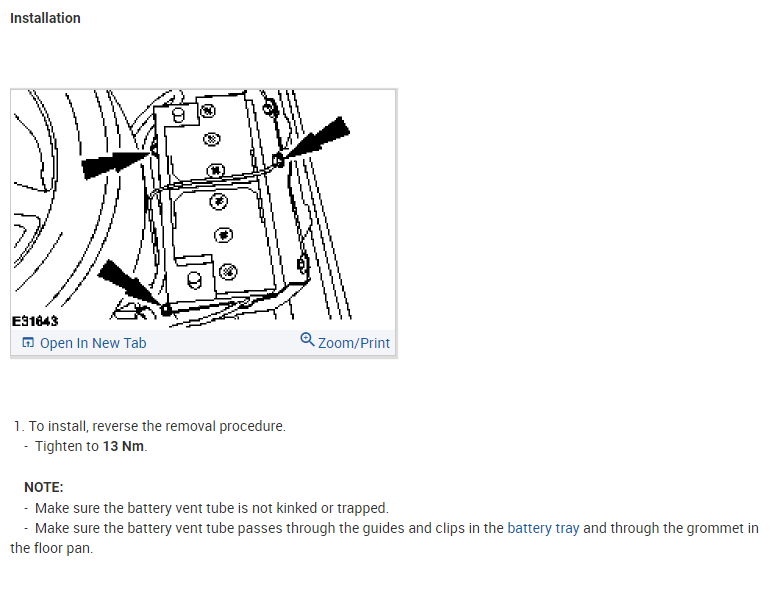

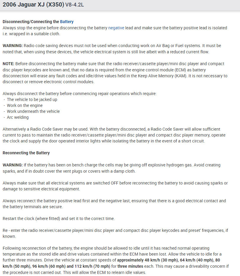

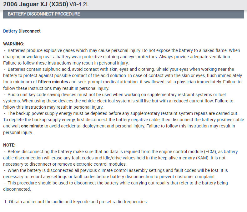

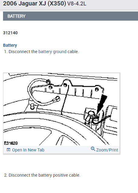

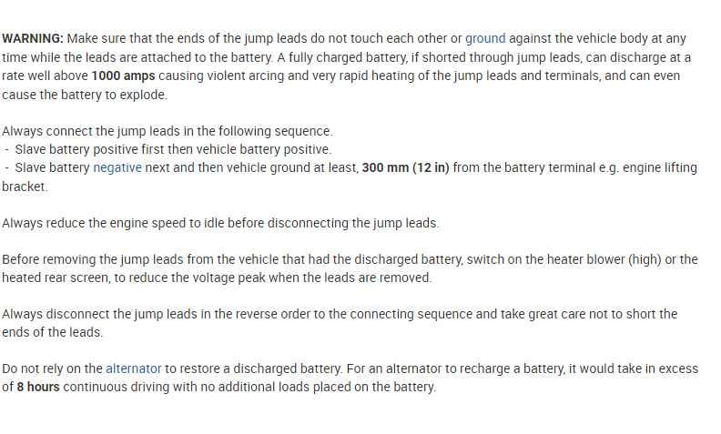

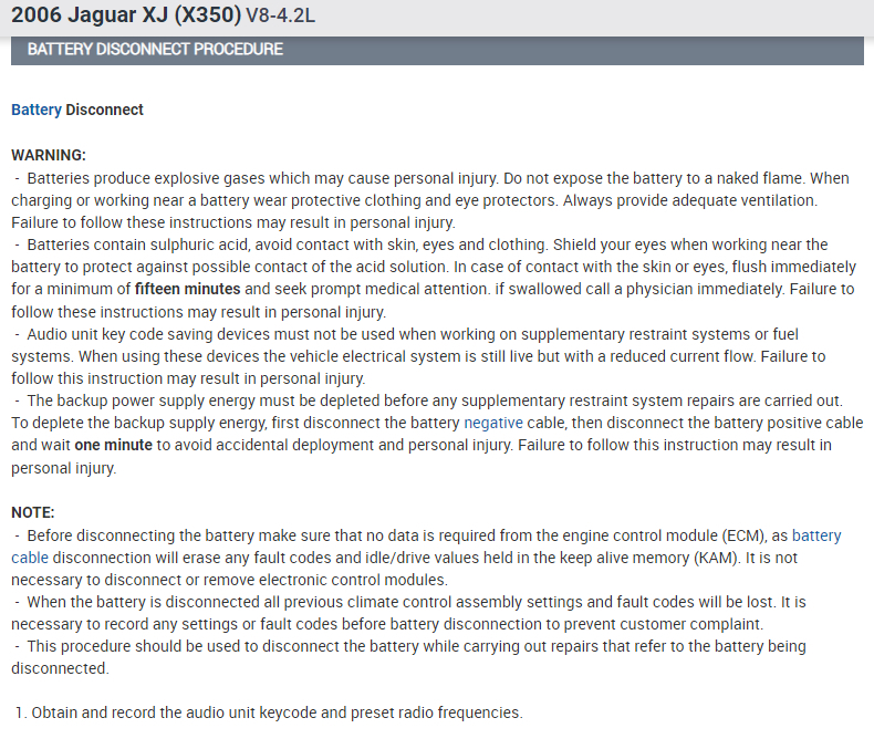

The battery for this XJ is located in the trunk.

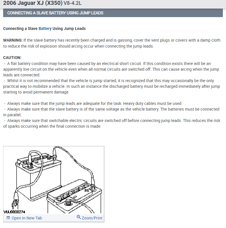

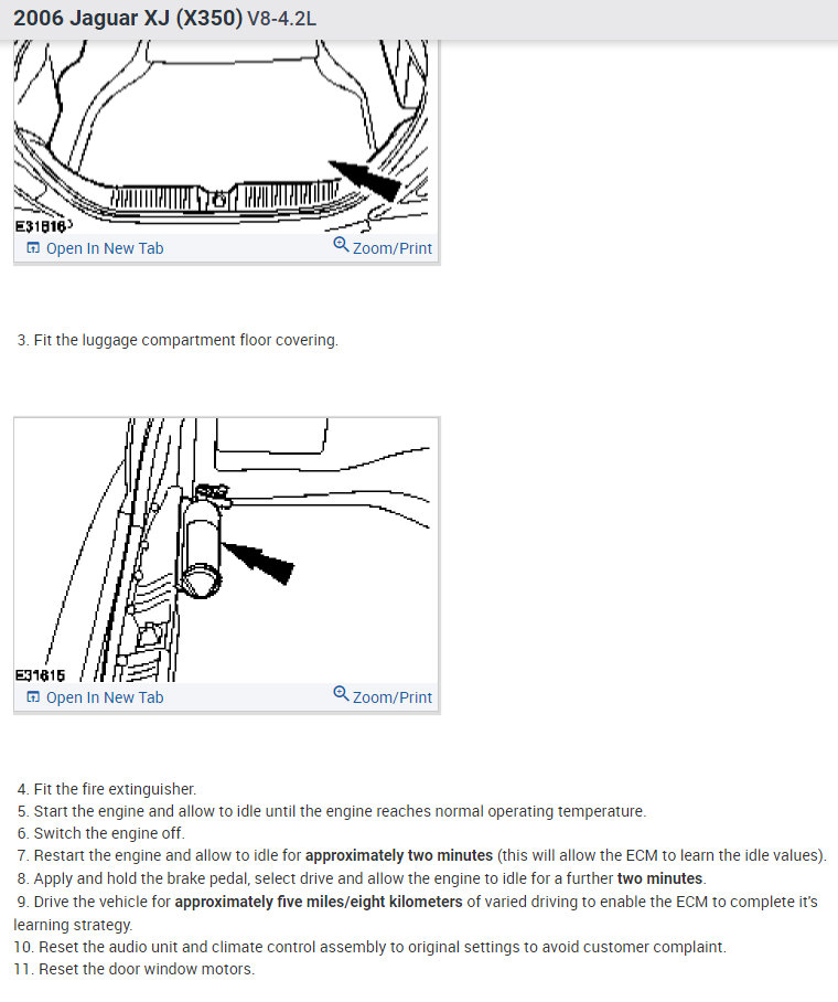

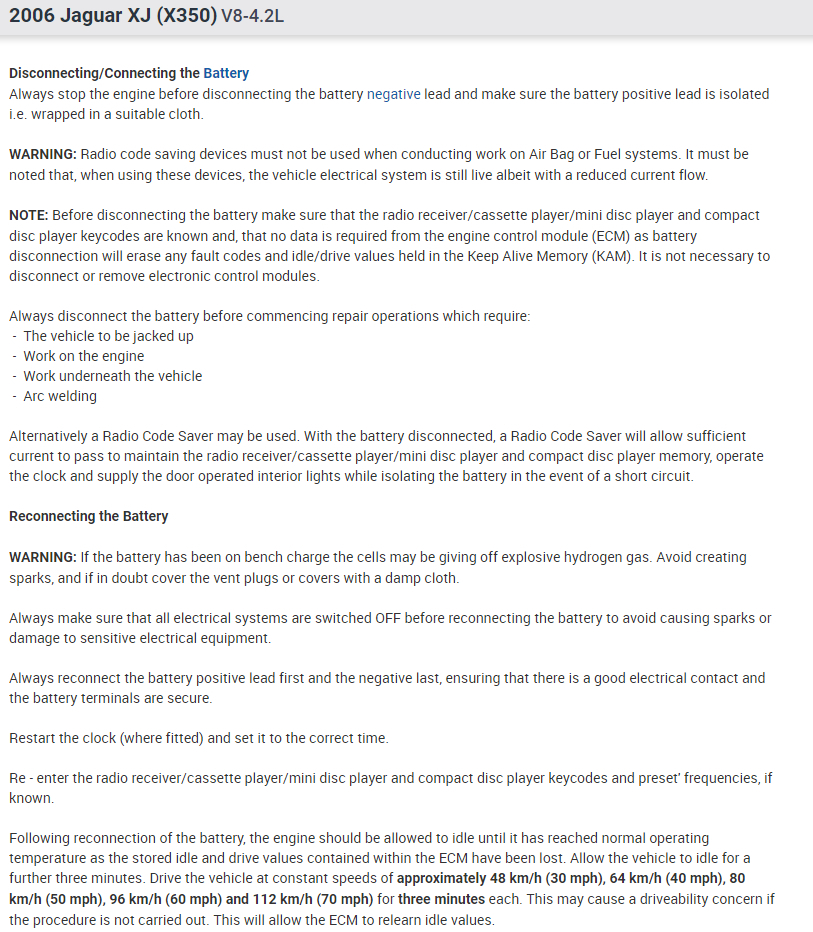

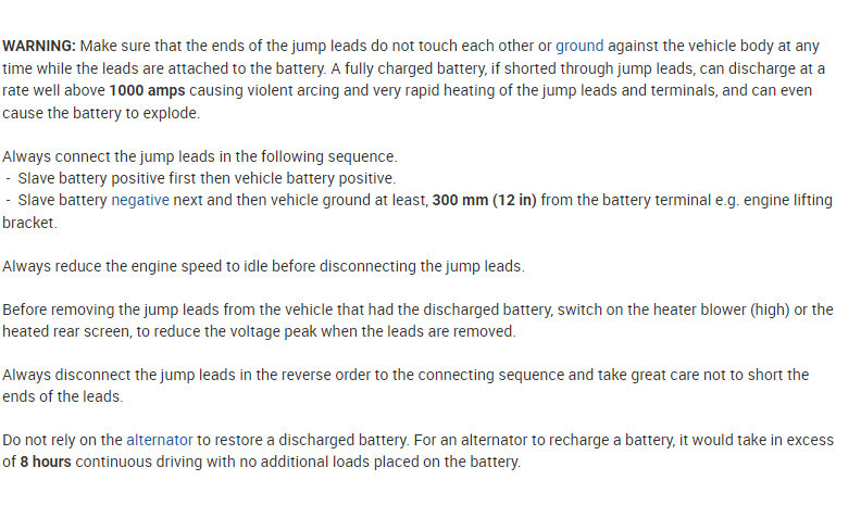

It is recommended to use a secondary 12V source when replacing the battery to power the vehicle, otherwise the radio will lock up and you will need the radio codes to unlock it.
https://www.2carpros.com/articles/how-to-replace-a-car-battery
I have included all the factory recommended procedures as well as best practices below.
