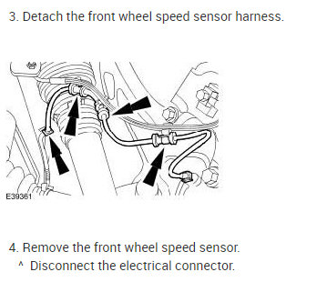

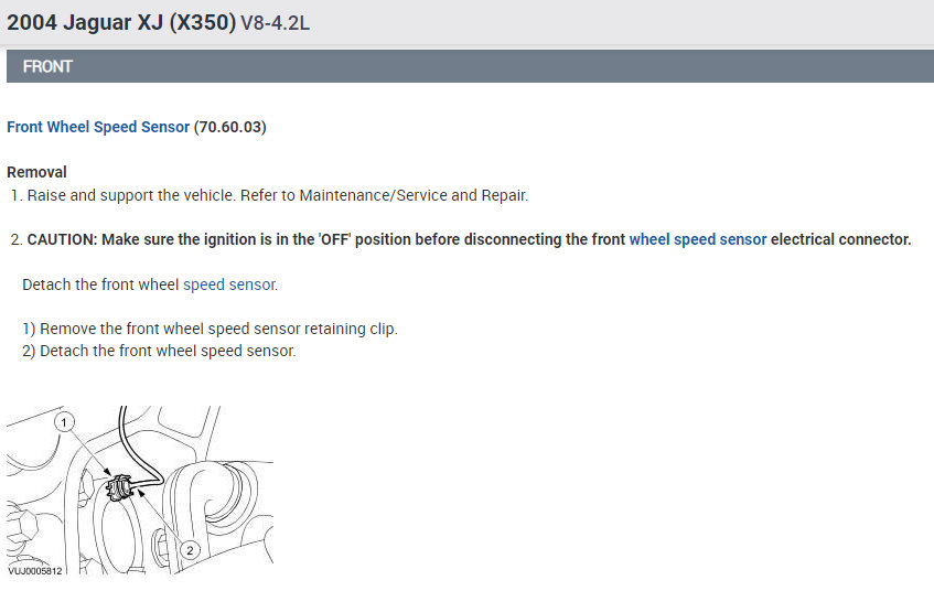

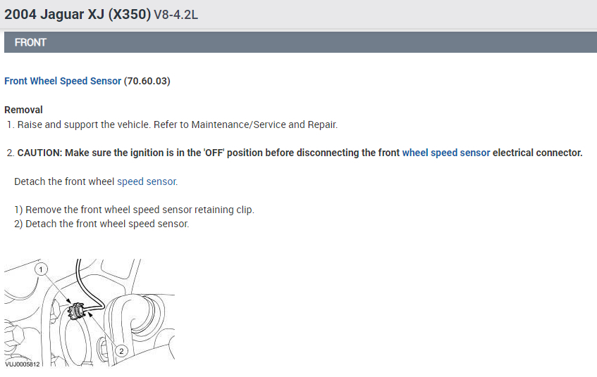

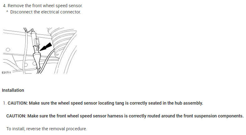

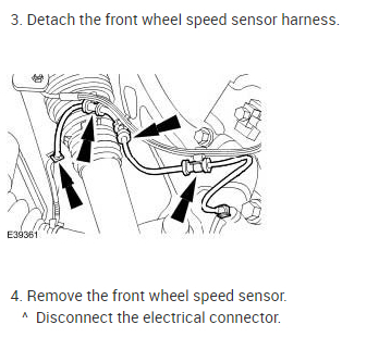

While driving car slowed to idle stayed running, would not move even with pedal to floor. Showed 1 ABS fault, I need the right front wheel speed sensor
Oct 17, 2010 at 10:10 PM
DANNY L
  • 5,648 POSTS
Hello, I'm Danny.
Here is the information you requested. Here is a guide to help you step by step with instructions in the diagrams below to show you how to perform the repair on your car:
https://www.2carpros.com/articles/how-to-replace-an-abs-wheel-speed-sensor
I've attached picture steps below on how to change the wheel speed sensor on your car. Hope this helps and thanks for using 2CarPros.
