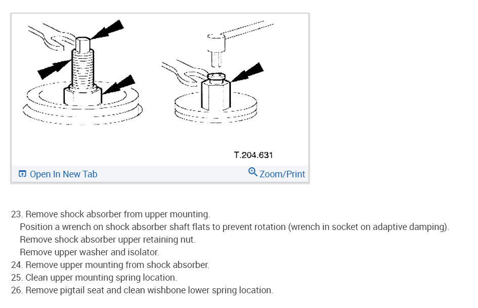

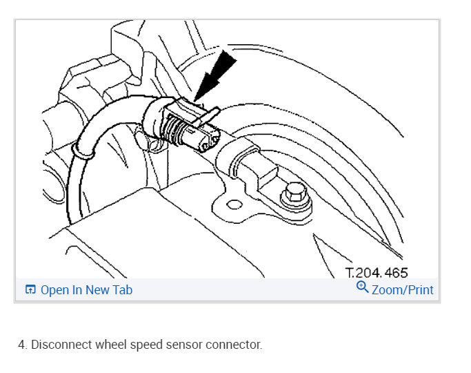

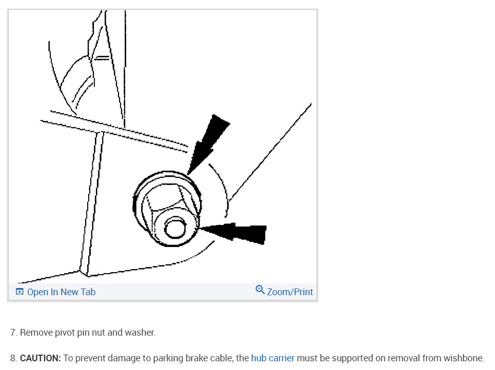

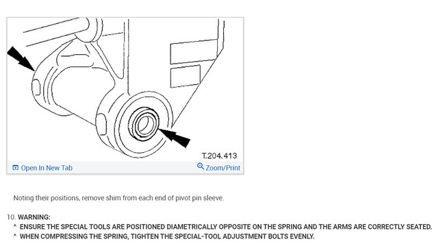

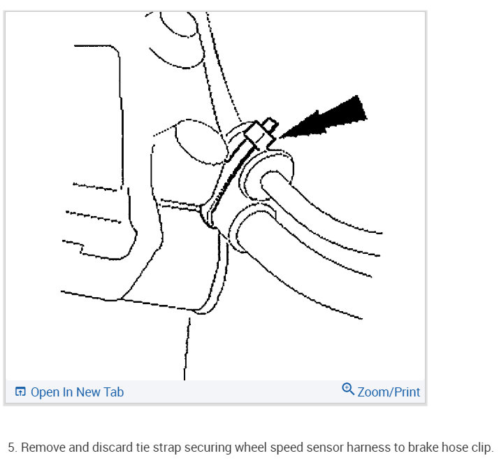

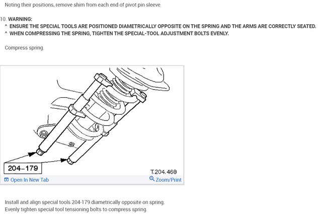

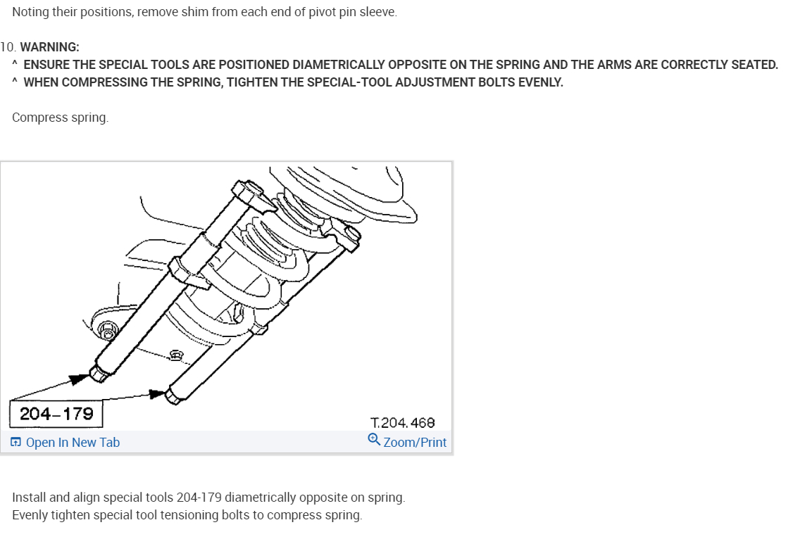

My rear shocks need replacement. Prices are all over the place for both the parts (Monroe, KYB on the low end, OEM on the high end). I am inclined to go with OEM, but need to know how hard it is to replace the shocks? Can I do it myself or are special tools and a lift required?

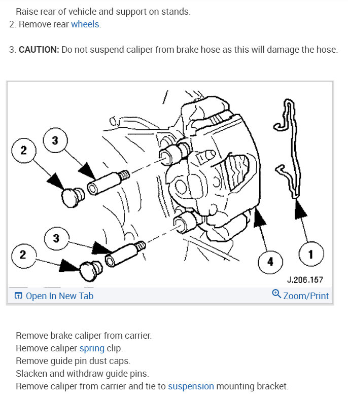

Raise the rear of the vehicle and support on axle stands.
Remove the relevant rear wheel. Refer to WHEELS & TIRES article.
CAUTION:Do not suspend the caliper from the brake hose as this will damage the hose.
Remove the brake caliper from the carrier.
Remove the caliper spring clip.
Remove the guide pin dust caps.
Slacken and withdraw the guide pins.
Remove the caliper from the carrier and secure to the suspension mounting bracket using a tie strap.

Disconnect the wheel speed sensor electrical connector.
Fig. 43: Disconnecting Wheel Speed Sensor Electrical Connector

Remove and discard the tie strap securing the wheel speed sensor harness to the brake hose clip.
Fig. 44: Removing Tie Strap Securing Wheel Speed Sensor Harness To Brake Hose Clip

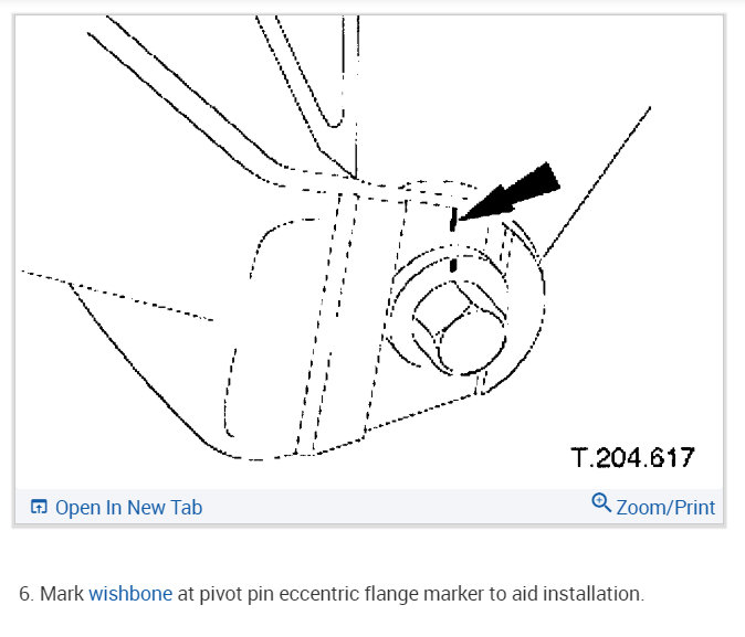

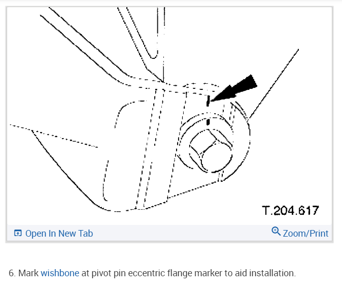

Mark the wishbone at the pivot pin eccentric flange marker to aid installation.
Fig. 45: Marking Wishbone At Pivot Pin Eccentric Flange Marker To Aid Installation
Courtesy of JAGUAR CARS, INC.
Remove the pivot pin nut and washer.
Fig. 46: Removing Pivot Pin Nut And Washer

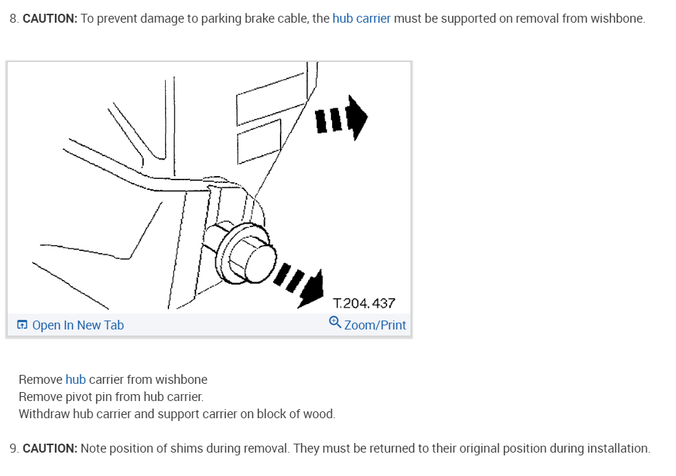

CAUTION:To prevent damage to the parking brake cable, the hub carrier must be supported on removal from the wishbone.
Remove the hub carrier from the wishbone.
Remove the pivot pin from the hub carrier.
Withdraw the hub carrier and support on a block of wood.
Fig. 47: Removing Hub Carrier From Wishbone

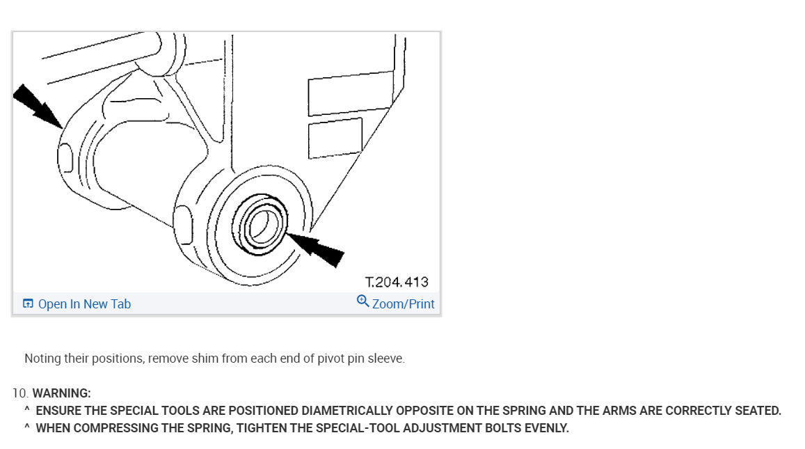

CAUTION:Note the position of the shims during removal. They must be returned to their original position during installation.
Fig. 48: Removing Shim From Each End Of Pivot Pin Sleeve
Noting their positions, remove the shim from each end of the pivot pin sleeve.

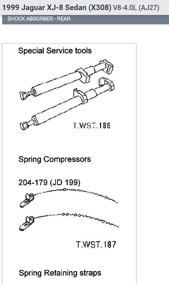

WARNING:ENSURE THE SPECIAL TOOLS ARE POSITIONED DIAMETRICALLY OPPOSITE ON THE SPRING AND THE ARMS ARE CORRECTLY SEATED.
WARNING:WHEN COMPRESSING THE SPRING, TIGHTEN THE SPECIAL-TOOL ADJUSTMENT BOLTS EVENLY.

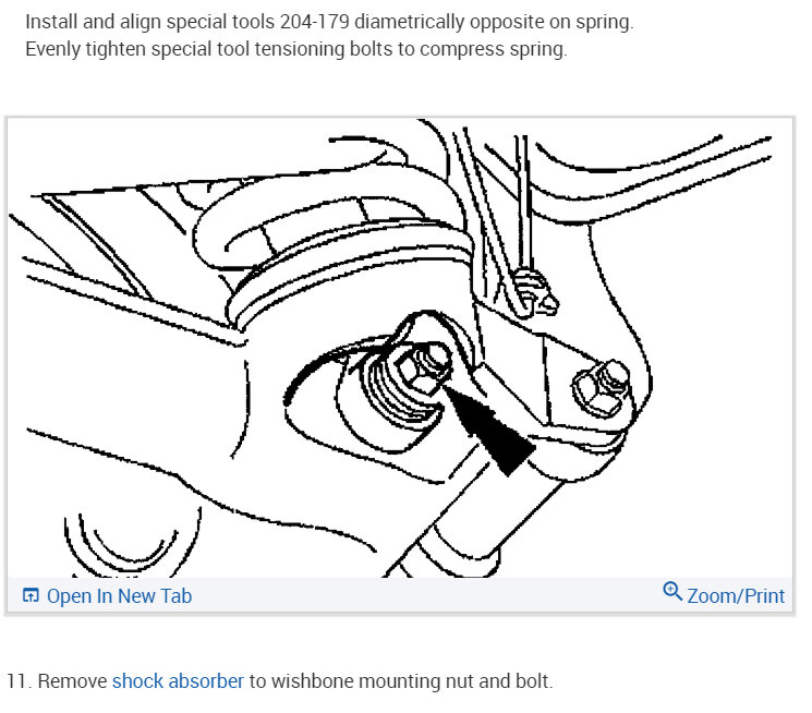

Compress the spring.
Install and align the special tools 204-179 diametrically opposite on the spring.
Evenly tighten the special tool tensioning bolts to compress the spring.
Fig. 49: Compressing Spring
Remove the shock absorber to wishbone mounting nut and bolt.

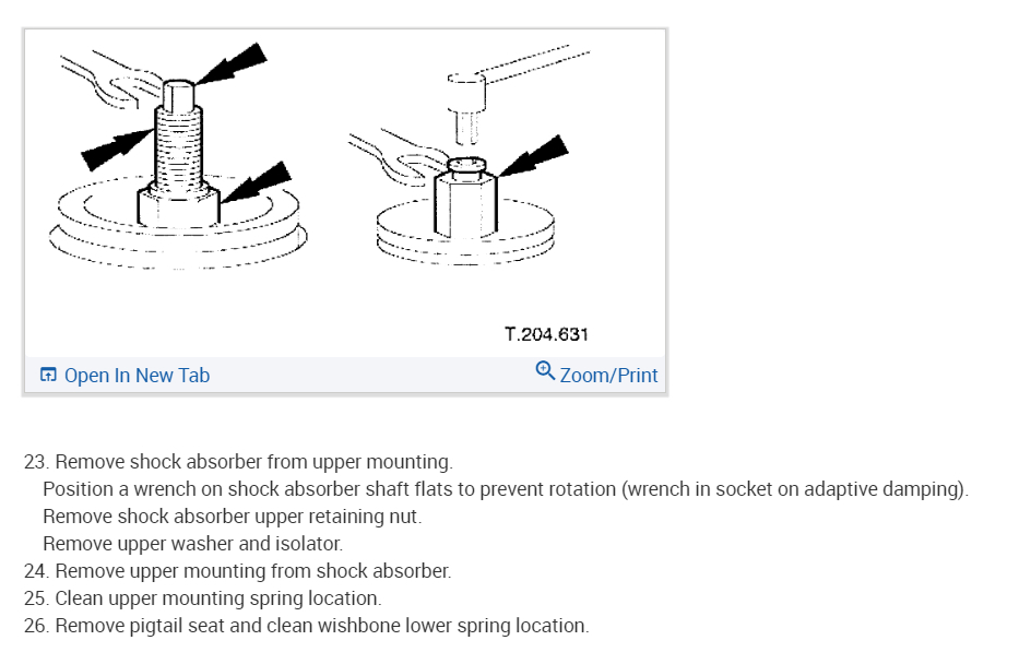

Remove the shock absorber from the upper mounting.
Position a wrench on the shock absorber shaft flats to prevent rotation (wrench in socket on vehicles with adaptive damping).
Remove the shock absorber upper retaining nut.
Remove the upper washer and isolator.

check out the diagrams below to do the job of removing the rear shocks you will need a special tool which is listed as well.
COIL SPRING & SHOCK ABSORBER
Removal & Installation
Raise vehicle and support at lift points with stands. Position floor jack under control arm. Remove bolt retaining top of shock absorbers to suspension assembly crossmember.
Remove nuts retaining shock absorbers to lower mount. Using a drift, remove mounting piece. Remove shock absorber and coil spring assembly.
Using spring compressor and adapter, collapse spring until collets and spring seat can be removed. Release pressure and separate shock absorber from spring. To install, reverse removal procedure.
