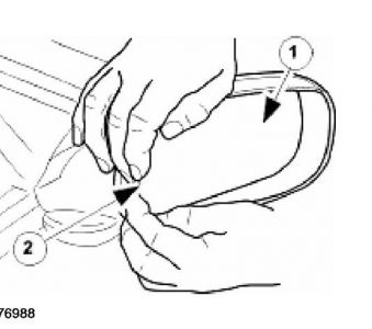

Sorry, It was not the wing mirror assembly I was asking about, simply the mirror itself which I plan to replace.
Thanks in anticipation.
Mar 12, 2010 at 6:11 PM
DAVE H
  • 13,384 POSTS
Removal CAUTION:If as a result of accidental impact, a powered fold-back mirror is moved 'out of position', it must only be re-positioned by initiating the fold-back sequence as described in this article. No attempt must be made to manually return the mirror to the normal position. Failure to adopt this procedure will result in vibration of the unlocked mirror head and consequent loss or distortion of rear vision. Remove exterior mirror glass. Motor glass to fully inward position. (1) Pressing inner edge of glass outwards, ease outer extremity rearwards away from mirror housing. (2) Fig. 9: Removing Exterior Mirror Glass

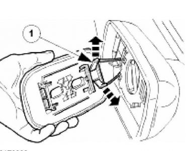

Disconnect and remove mirror glass. Ease glass clear of base, disconnect the two spade connectors and remove glass from mirror housing. (1) Fig. 10: Disconnecting And Removing Mirror Glass
https://images.2carpros.com/forum/automotive_pictures/266999_jag2_4.jpg
Installation Fit glass to mirror housing. Holding glass in position, connect the two spade connectors. Engage the mirror inner retainer on the motor lug and press the mirror outer edge forward to engage the outer retainer.
