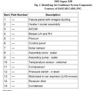

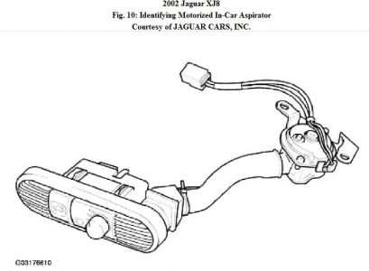

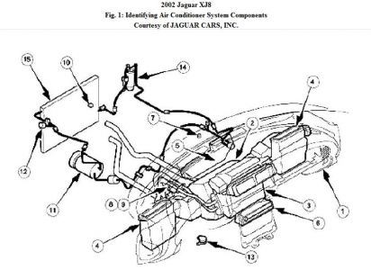

Hello .. thanks for the donation .. much appreciated This sounds from your description, like you have a fault on the Motorized In-car Aspirator ... my manual does not supply any test procedure for this unit !! you could try disconnecting the wires and see if you get the same symptoms ? hope this helps .. let me know ! Motorized In-car Aspirator An intake grille (mounted on the fascia, outboard of the steering column and below the EOD vent) houses the aspirator thermister. The remotely mounted motor / fan assembly draws cabin air through the grille and thus over the thermistor; a flexible hose connects both components. The electrical resistance of the thermistor changes in response to variations in air temperature, this change being converted into an electrical signal. The A/CCM uses this signal to adjust the temperature, airflow and air distribution from the air conditioning unit.
https://images.2carpros.com/forum/automotive_pictures/266999_asp_1.jpg
11 Motorized in-car aspirator malfunction Possible Source(s): Harness/connector fault Sensor open/short circuit Action(s) to take: Panel fault codes are not stored for motorized in-car aspirator motor failure.
https://images.2carpros.com/forum/automotive_pictures/266999_asp2_1.jpg
https://images.2carpros.com/forum/automotive_pictures/266999_asp3_1.jpg

I removed the Motorized in-car aspirator and tested it, the small fan runs and the termistor's resistance changes when you warm it.
When running the engine with the aspirator removed it seems to operate as normal but perhaps not as good at regulating the temp, as you would expect.
With the engine running (and warm) I tried cooling and heating the aspirator's termistor and the system reacted to that as expected. Also I did not see the failure having waiting 30 mins but perhaps it does not show with the car stationary or perhaps I did not quite leave it long enough.
So I'm thinking that's not the problem.

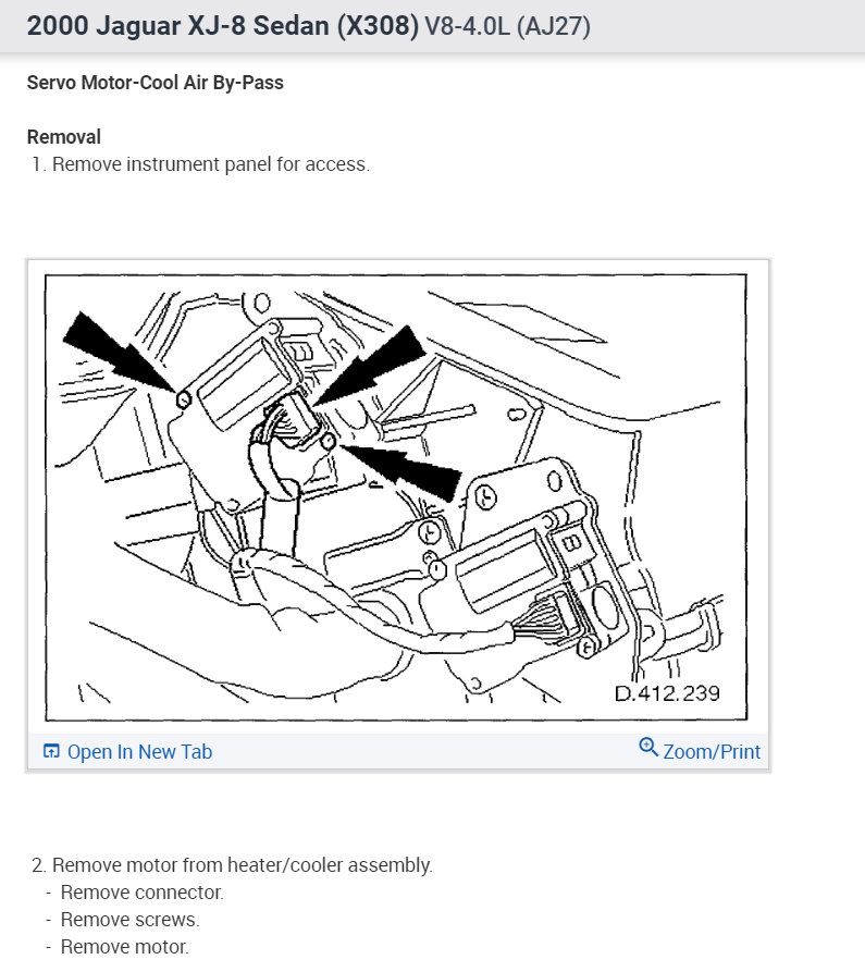

Good day. Okay the car is a 2000 Jaguar XJ8 base 4.0l with single climate control. The problem is the HVAC will blow cold after driving for about 30 minutes. When this happens, you can change anything on the controls and it will not make a different. If you pull over shut the car off wait 5 min start the car the heat will come back sometimes. Now this is the odd part it will only do this if the temp outside is below
0 deg C. any time it is above 0 all work great.
Also, there are no error codes in the HVAC
I have replaced the heat pump and heater control valve (engine compartment) with brand new units.
New thermostat flushed the system. Back flushed heater core. Pulled out the Aspirator checked it and it works fine. So, the only thing left to do is pull the hot-cold blend door vent servo motor but I can not find were it is one tag said it is on passenger side floor easy to remove but its not there. On another tag it said driver side behind dash cluster. But there is no way to take it out sheet metal for dash in the way.
If this is the right one not sure.

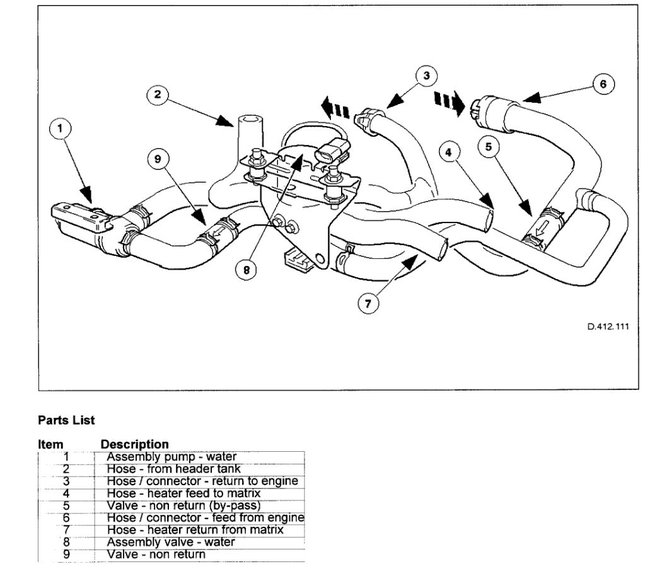

That sounds like the circulation water pump protection circuit has an issue. It is supposed to shut off the pump if the coolant temperature is read as below 16C I would get it to shut down, then go out and feel the hoses around the pump. See if the water is actually moving. Or you could try a jumper from battery positive to the yellow wire that feeds the pump voltage.
Do you have a scan tool that can read live data, you might look at what it shows for coolant temperature when this happens.

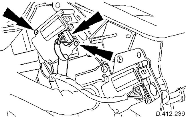

As for the cold air bypass, aka blend door, you need to remove the dash to get to it. Then it takes about 30 second to change! However I cannot think of a reason why it would be temperature responsive. It's nothing more than a motor and a position sensor. They normally just fail in one position or will set a code if the sensor doesn't detect motion when the control attempts to move it.

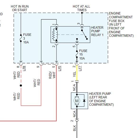

Okay, here is what I am going to do: I am going to hook up a small light 12 volt to the pump yellow and black wire and feed the wires and light out side the hood at the base of the windshield. The light should stay on as long as the pump has power. As my wife drives if the air gets cold the light should go out and then I would know that the wires or the relay are my problem. I need to do it this way because it never gets cold running the engine in the driveway and you can never know when its going to happen. I will all so try the scan tool I have one that stores all data for 4 hour and then I can look at it on the computer.
I will get back to you after I try this idea. thank you.

Good day, so i hooked up the light and by luck the wife went for a drive and you guessed it the temperature went cold but the light stayed on. so that tells me it's not the pump or the wiring to it. So I though i would play with the heater control value. started the car all heated up and I unplugged the value it did get colder but i think it went to its default temperature which is 77 degrees not as cold as when your driving but maybe you need the wind to cool it down more. But what i found interesting was if you plug the value back in with the car still running the temperature will stay cold until you shut the car off and let the HVAC reset. just like when your out driving. this is the closes i have come to reproducing this problem. So i am now going to pull off the value and have a look at it. Do you know does the value work on 12 volts?

Yes it works on 12 volts, can I ask if when the heater blows cold can you hold each heater hose coming out the firewall to see if the are hot? If so you have a blend door actuator that could be bad and loses its value which makes it move. Here is the location so you can check it out. Check out the diagrams (below). Please let us know what you find. We are interested to see what it is.

Okay, the motor is working which is a good thing. With the extra info you gave it sounds like the system is shutting off the coolant flow, if it was a blend door I would expect it would go from heat to cold almost instantly as the door closed, not a slow progression to cold air.
As a test you could bypass the heater valve mounted in the rats nest of heater hoses in the engine compartment. Then see if the system stays hot. If it does then there is some issue with the controller itself telling the valve to stop sending hot water to the heater core.
