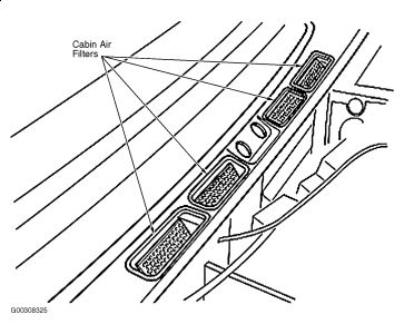

Have this strange noise when swerving or driving over the raised gutter into my driveway at home. Sounds like a dull thunk and I swear it is under the dash. My mechanic thought it was outside near firewall. They searched, couldn't find anything. Quite obvious when it happens. I can make it thunk by swerving the car sharply right to left or vice versa. Mechanic checked sway bar, frame, firewall area - nothing. To me it almost sounds like something inside the duct work under dash, kind of like a trap door closing. Weird, any thoughts?
Also where in the heck is the cabin air filter located?

CABIN AIR FILTERS
Removal & Installation (1998-2003)
The air particle filter system (if fitted) is located in the plenum below the windshield. See Fig. 1 . The filter elements are retained by adhesive strips which are attached to the filter molding. The filter is fitted with the light flocked surface facing towards the engine. Removal and installation procedures are not available from the manufacturer.
Fig. 1: Locating Air Particle Filter System
https://www.2carpros.com/forum/automotive_pictures/266999_jag_96.jpg
