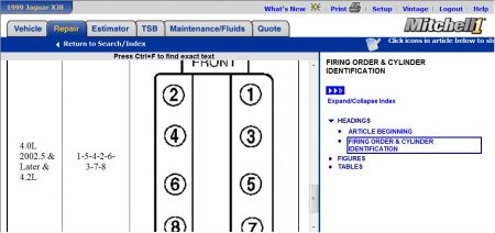

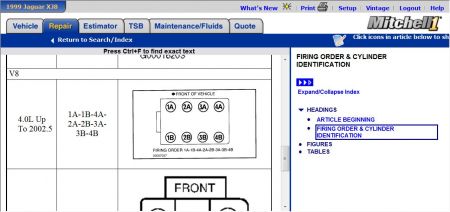

1999 xj8 running rough low rpm saying P0304 which side is # 4 cylinder on and which cyliner.
Aug 20, 2010 at 12:30 PM
  • 75,992 POSTS
Hi isjeh061654, Welcome to 2carpros and TY for the donation You have a misfire at cyl. no.4 -recommend you check the sparkplug/compression/injector
