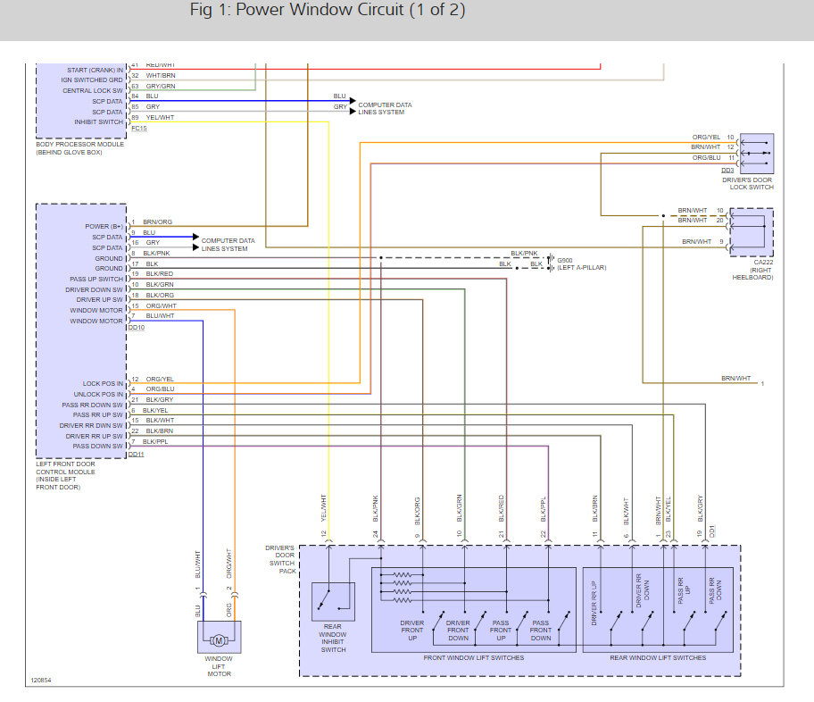

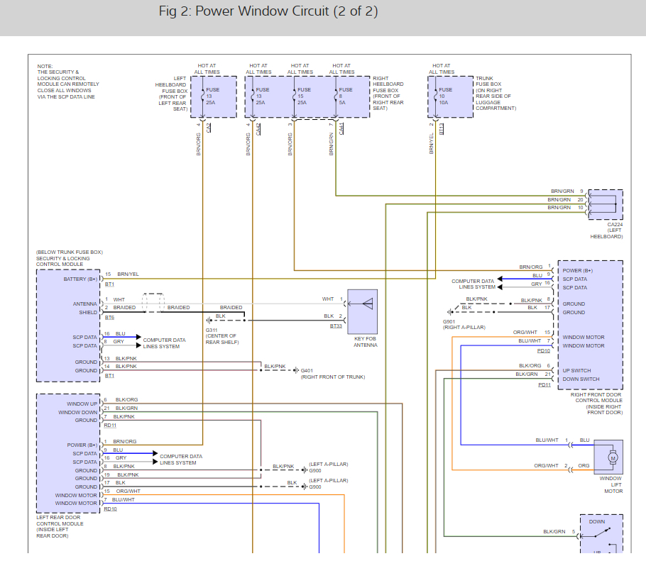

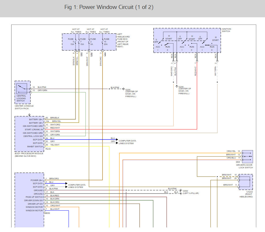

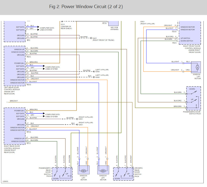

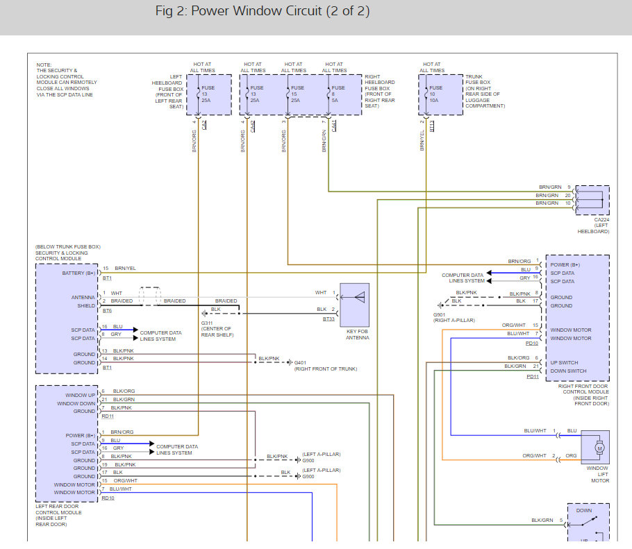

Here are wiring diagrams so will more know what I'm talking about. The unknown switch on the driver's switch pack is a lockout for the rear windows. The first thing we need to check is power to the driver's window motor.
Cheers
Dec 13, 2008 at 3:27 AM

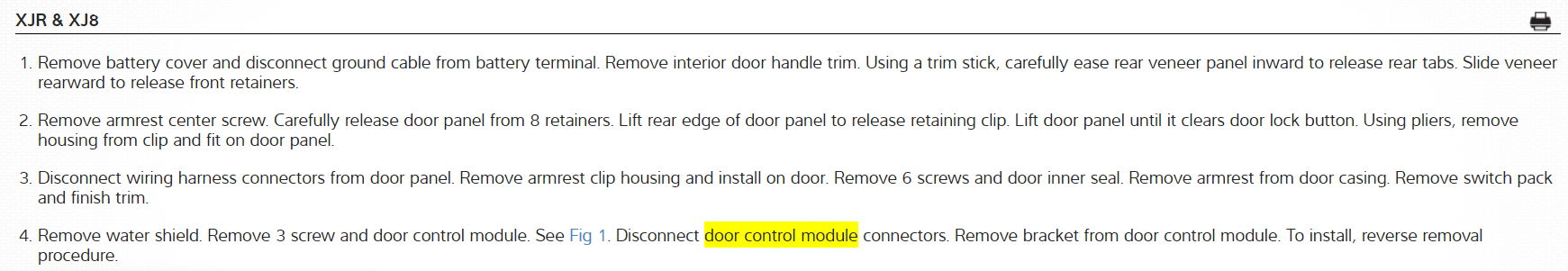

STEVEN LAIKIN
I reset the module and the problem returned a few weeks later, any more suggestions?
Dec 6, 2018 at 1:27 AM
  • 55,548 POSTS

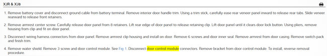

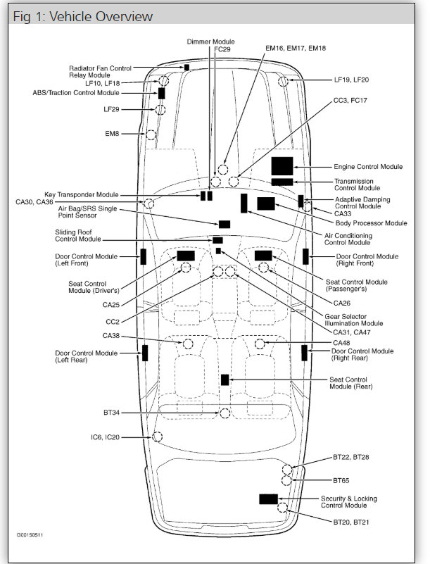

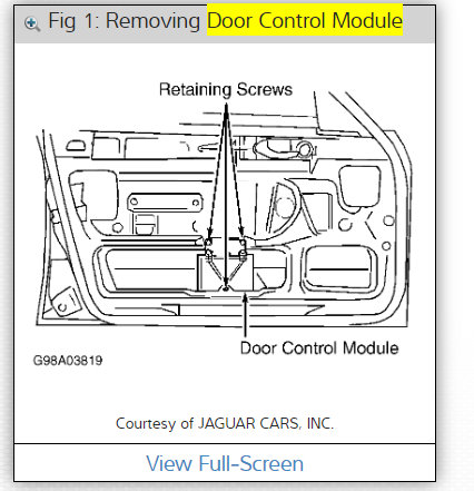

Yes the drivers door module is bad and needs to be replaced. When doing so it will need to be programmed to the car. It should cost about $130.00 for the programming. You can try a used unit as well it might plug and play.
