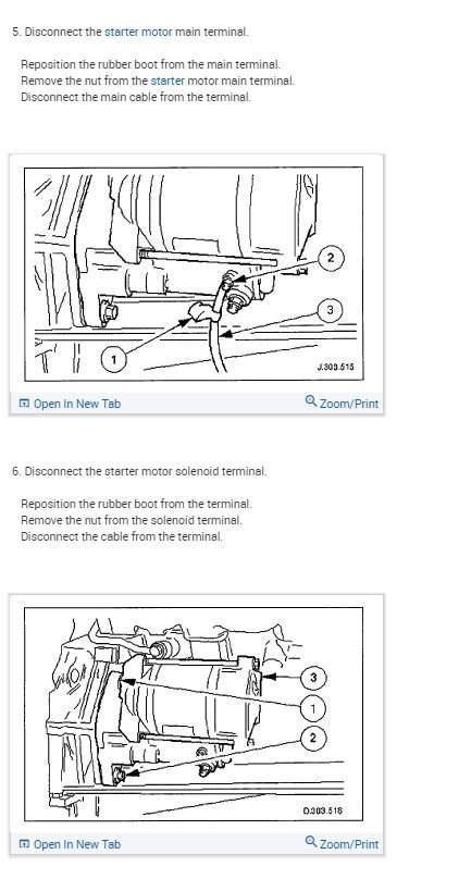

where is starter and solenoin on my cat.... does one click when trying to start usually mean a starter problem?

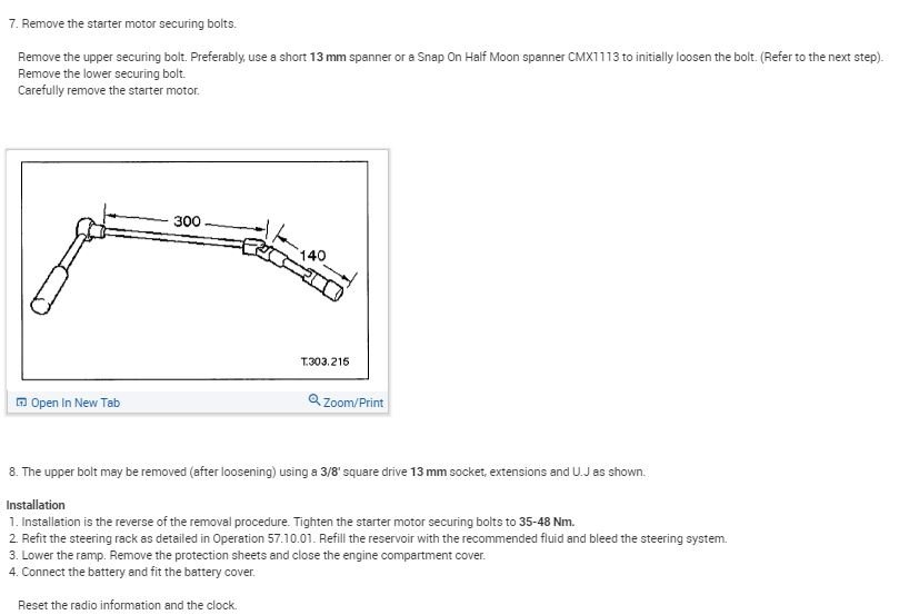

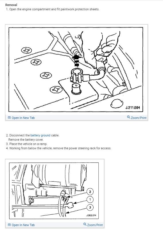

start by checking battery is good .. or replace the starter motor ! If vehicle goes dark(no power) when it clicks it sounds like a bad connection at the battery.. otherwise its probably the starter.
Its located under the vehicle, where at the bell housing.. see instructions for replacement below
