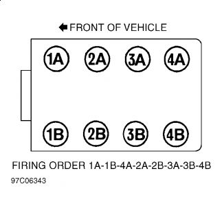

https://images.2carpros.com/forum/automotive_pictures/266999_jag_35.jpg
