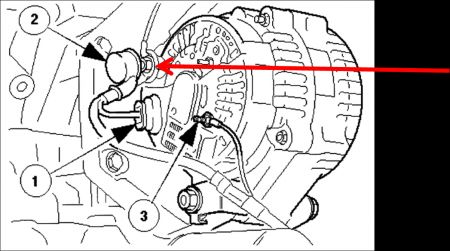

dead battery located in trunk, no trunk key, cigar lighter not working, cannot access trunk through back seat, where do we jump it off or get enough power to get the trunk open by remotes....please be specific to location to jump....cannot find a positive cable under the hood.

Hello –
To better assist you is your vehicle a XJ-8 Sedan, 8L Sedan or Vanden Plas.
I don’t have a pic of your engine bay but you should have a main hook up there. A heavy post with a heavy wire going to it with a cover on it. Many are near the firewall.
You might try putting the ground on a metal part of the engine and then the positive on the heavy wire on the alternator……do not touch anything else…………just the bolt that he covered heave wire is under. This is the positive then start the car.
What I have done since I can’t take responsibility for something going wrong here it does seem logical to put 12 volts right there to start the car then open the trunk.
You can either try it or, I have contacted a couple of other moderators to also advise.
Also, please at least return my answer on the model and maybe I can find something better.

it is just a xj8......nothing else......there is not a post to jump off of. I do not have the ability to send a picture.

You can do it at the battery terminal of the alternator or the starter as you wish

Hello - I have attached a pic of your alternator with an arrow pointing toward the connector to hook your positive cable to. Then pick an engine bracket to connect the negative to. Try to push the trunk button then. If not working then turn the key to the on position, if not working then start it.

ImpalaSS is correct. You should be able to attach your positive jumper cable to the output terminal of the alternator and "back charge" the battery enough for the remote system to work. BUT, do not, I repeat, DO NOT, try to start the car with the jumper cable attached to the alternator. That circuit is not heavy enough to handle the starter load and you will blow something. If need be, let the jumper cables charge the battery for 20 to 30 minuets, remove the cables and then try to start the car. Hope this helps.

Thank you for all your help. I could not get to the alternator but did find a "hot " wire and was able to splice into it and get enough juice to pop the trunk.
