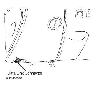

Where is my diagnostic point on my r hand drive Jag (2000 reg)

RETRIEVING DIAGNOSTIC TROUBLE CODES Turn ignition off. Connect Jaguar Portable Diagnostic Unit (PDU) scan tool or generic scan tool to 16-pin Data Link Connector (DLC). See Fig. 2 . If using PDU, see PDU User Guide for operating instructions. If using generic scan tool, follow scan tool manufacturer's operating instructions. Check for and note any DTCs. Also check for and note Freeze Frame Data. See DIAGNOSTIC TROUBLE CODE DEFINITIONS . Fig. 2: Locating 16-Pin Data Link Connector (DLC)
https://images.2carpros.com/forum/automotive_pictures/266999_jag_117.jpg
