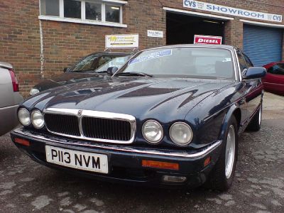

AIR CON AND HEATER BLOWERS WORKING FINE BUT DO NOT BLOW HOT WHEN ENGINE WARMS UP THEY JUST BLOW COLD, HAVE CHECKED FUSES BUT SEEM OK,
WINDSCREEN WASHERS NOT WORKING HAVE TAKEN TUBE FROM JET BUT NO WATER IS PUMPING THROUGH FROM BOTTLE TO WASHER UNIT, HAVE CHECKED FUSES BUT SEEM OK.[img:e5753ab2e6]http://www.2carpros.com/forum/automotive_pictures/133948_CRAWLEY_1_1.jpg[/img:e5753ab2e6]

Nice ride
Okay start by locating the thermostat and test or replace it and go from there-could also be a heater control valve,actuators, and vacuum hoses-that controls the air mix/blend door.
