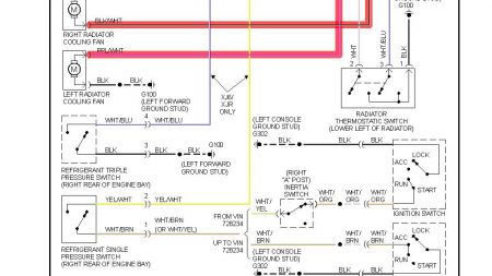

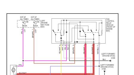

Engine Cooling problem
1997 6 cyl Two Wheel Drive 113,00 miles
engine over heated fan not working is a fuse involved
Aug 17, 2008 at 9:55 AM
  • 75,992 POSTS
Could be the fuses no.11 and 17 in engine bay fuse box/fan relay control moduel/thermos switch-also review wiring diagram
https://images.2carpros.com/forum/automotive_pictures/12900_cf1_6.jpg
https://images.2carpros.com/forum/automotive_pictures/12900_cf2_7.jpg
