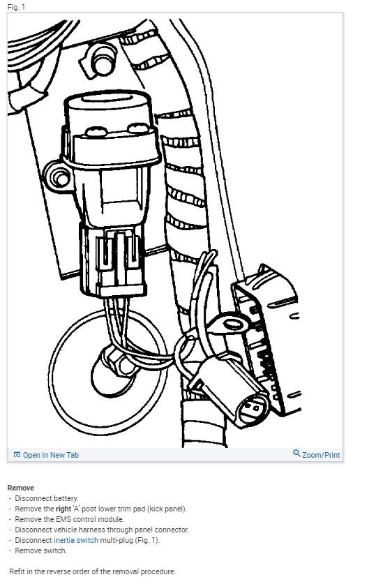

I believe that my inertia switch has activated and I cant find it.

Switch is located under the driver's side of the dash on the outside kick panel up next to the firewall.
Read the guide below to see how to use a test light to verify if power is making it through the switch
Attached below is instructions on replacing the switch
