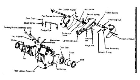

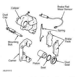

I AM IN BIZ FOR MYSELF, DON'T DO A LOT OF IMPORT WORK. TRYING TO FIX THE BRAKES FOR MY STEP SON. HAVING DIFFICULTY REMOVING REAR CALIPERS. IS THERE A SECRET?
Aug 4, 2010 at 6:29 PM
BLUELIGHTNIN6
  • 16,542 POSTS
Hello and thanks for donating There is nothing special about replacing the rear calipers on this jaguar. Steps are below, what exactly are you stuck on as far as not being able to remove them?

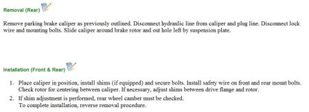

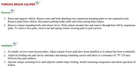

it is a 1983 Jaguar XJ6. So sorry.
Aug 5, 2010 at 8:35 PM
BLUELIGHTNIN6
  • 16,542 POSTS
No problem. The parking brake caliper will need removed first in order to service the rear brake caliper. I have placed the removal steps for the parking brake caliper along with the remaining steps for the regular rear caliper below. . Hope this helps you out..
