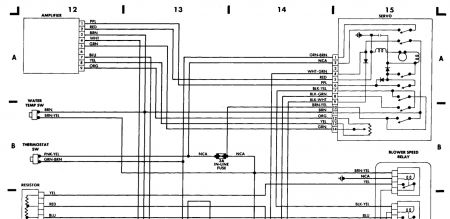

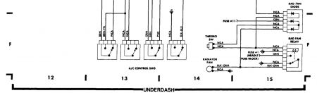

need blower switch wiring diagram.the switch has 9 terminals 4@top and 5@ bottom or vice verse.the switch is sometimes called the micro switch. the sequence is as follows; off#1 second position low..automatic high then defrost.the wires are brown..brown/yellow red/white stripe pink black black/white black/green green.note the blower switch is on the right side. note pay pal has already taken care of the price.if you need a fax I can supply one for the
picture of the switch.
thank you

Hello and thanks for donating The wiring diagram for your vehicle's HVAC system is below. I have also emailed a copy to your email address on file so that you can enlarge the image. .
https://images.2carpros.com/forum/automotive_pictures/261618_Noname_2509.jpg
https://images.2carpros.com/forum/automotive_pictures/261618_Noname2_820.jpg
https://images.2carpros.com/forum/automotive_pictures/261618_Noname3_300.jpg
