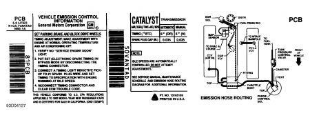

Hi, and thank you very much, this page is awesome. I hope you can help me. My car is having problems, when you start the car, sometimes when it reaches normal temperature it stalls until goes off. What can it be?
2- I need the vacuum diagram and can´t find it. Can you please help me

Hi comarpe, Welcome to 2carpros and TY for the donation Sorry for the delay Next time it stalls don't wait for nothing do below immediately to determine what's causing it-fuel or spark problem Get a helper disconnect a sparkplug wire or 2 and ground it to the engine atleast 3/16 away from ground-have helper crank engine over-do you have a snapping blue spark? If so-you have a fuel related problem, check the fuel pressure to rule out the fuel filter/fuel pump/pressure regulator and listen to the injector/s are they pulsing or hook up a noid light. No snapping blue spark continue to troubleshoot the ignition system-power input to the coil/coil packs,coil's resistances,cap and rotor,distributor pick-up coil, ignition control module, cam and crank sensors and computer Note: If it doesn't apply disregard it and keep testing
https://images.2carpros.com/forum/automotive_pictures/12900_jag_1.jpg
