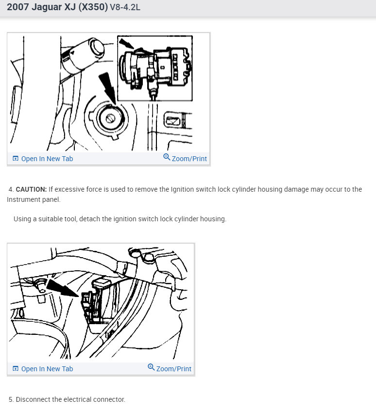

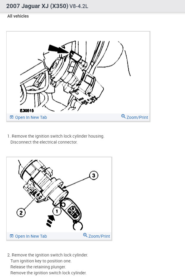

This could be due to a faulty ignition switch lock cylinder.
Worn components inside the ignition switch can cause it to lose contact when you try to start it.
This typically leads to no crank no sound while trying to start.
Also, you want to make sure that the starter is getting power. No power to the starter can be due to a bad switch or wiring issue.
It might be a good idea to apply 12V power to the starter to see if that cranks over.
