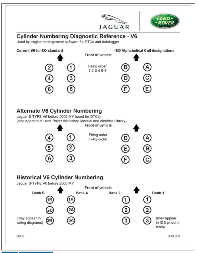

Please let me know the firing order, and the actual positions under the hood of cylinders 1 through 6.

Check the diagrams below it shows the engine ignition firing order. Check out the diagrams (Below). Please let us know if you need anything else to get the problem fixed.......................................................................................................
