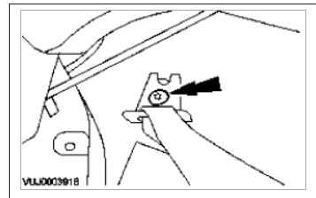

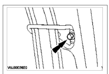

How can I remove the driver and passenger seat belts. The locking device is not working?

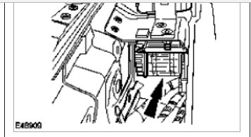

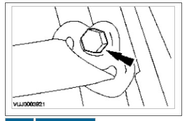

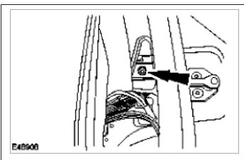

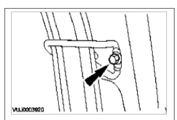

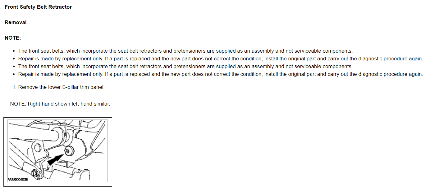

Here are diagram to let you see how the seat belt reactor is removed (below)
